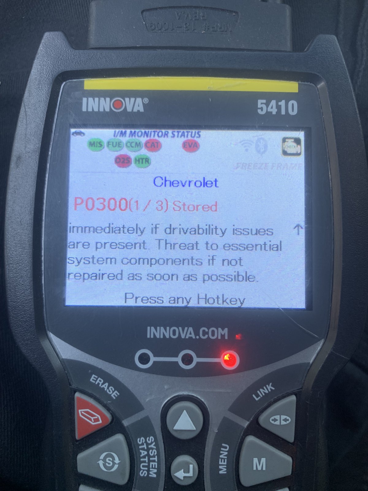

P0300 code after replacing parts
MalcDogg
MalcDogg
Mar 8, 2021
47
23
I scan it and it keeps saying P0300 check cats O2 sensors
Dustin Jackson
Aug 9, 2018
1,551
1,750
@MalcDogg Might be worth installing some of your old parts but a p0300 code is for a random misfire, it looks like your emission monitor for the o2 sensors isn't set yet so that could indicate a problem with the cats or O2 sensors.
I would start with a compression test and then maybe install your old O2 sensors?
