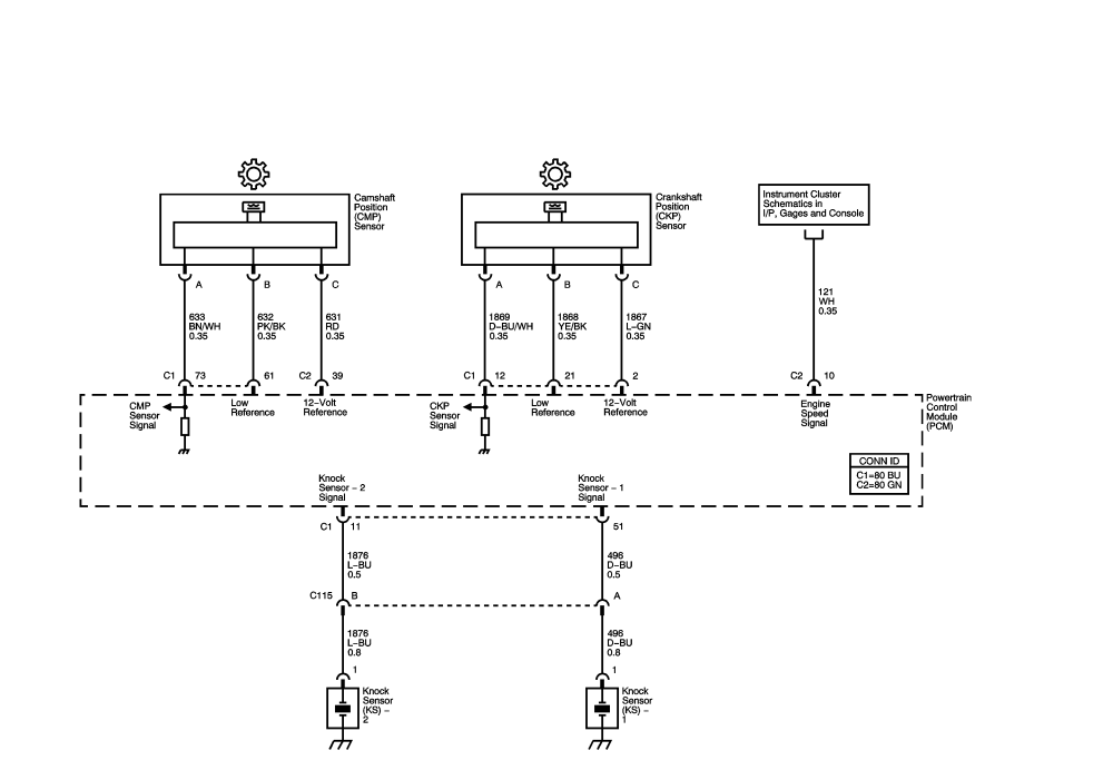

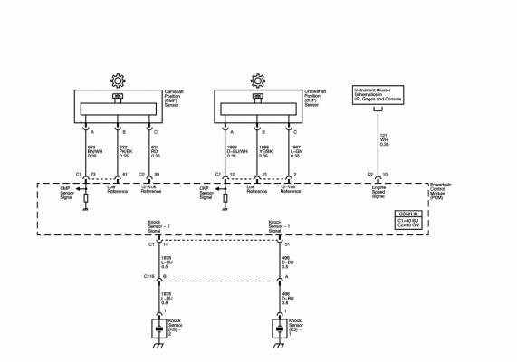

My first post, I have this issue and am looking for assistance. I have this code, so far I have replaced both knock sensors. First time with Advance Auto parts, including the pigtail. Second time with AC Delco sensors and pigtail. Both times the code reset within a day or two. I've checked the wires and can't find anything obvious wrong, they have zero ohms end to end and I can't make them short to ground. I replace the ECM. Still the code reset within a day or two. I'm thinking of cutting the wires at both connectors and splicing in new wire from end to end. Any other ideas?
