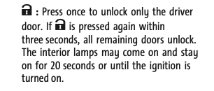

Need 2x press on key fob to unlock all doors, see this from owners manual:

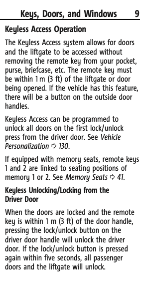

Keyless Access works slightly differently, here is the description if its operation from the owners manual:

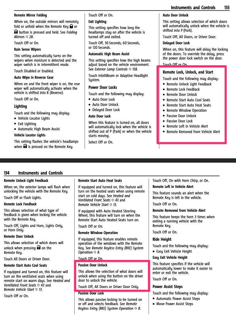

And here is the description of how to change the vehicle personalization from the infotainment to have it unlock all doors or only the door being pressed on the first click. Note, I think you need to do the following if you want all doors to unlock on any of the door lock button presses:
Enter Settings -> Vehicle -> Remote Lock, Unlock, and Start -> Passive Door Unlock
Then select "All Doors"

Appreciate it, but I’ve run through the manual and changed all of the settings. I’m currently at the dealership waiting, and they are confused as well. We will see, I’ll update the post if/when they determine the issue.
