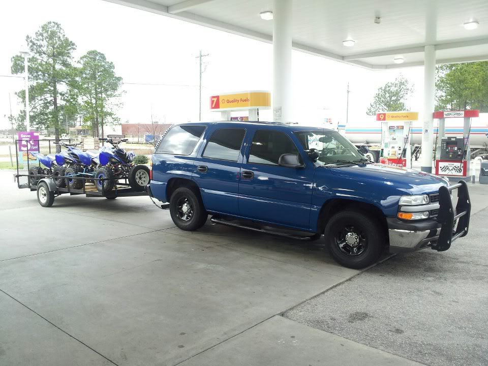

I have a 2005 Tahoe PPV and I have a question about aftermarket performance programmer computer type devices/displays. Is there one that will give me a real time display that includes the transmission temp? Something cool that mounts on the dash.
I want to pull a small trailer and dont have an override defeat button.
Just trying to be somewhat safe about it. I want to tow it about 3k round trip through the deserts of OK. The trailer loaded probably only weighs in at 1800lbs as shown below...

I doubt youll ever notice 1800 lbs back there, but i understant wanting to know what the tranny is doing.

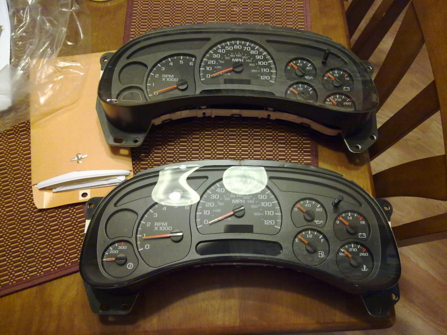

The slick setup is shop ebay for the guys that rework gauge clusters. They can get you one with the factory tranny temp gauge for just a bit more. they can also color the lighting, needles, characters, gauge surrounds, adapt an esky cluster, make it 150Mph speedo. basically whatever you want. and they program the DIC with you mileage and hours. Its usually an exchange for you cluster.
I had them rework mine and add the tranny temp gauge. It all worked like a charm. got it in about a week, then sent him my old one. the downside is it cost me about $300. but it looks like it was meant to be there. see the lower cluster, lower left gauge.
I can get you info on the service i used if you like.

I would go with WildBill's suggestion, as an added bonus if you get one with new lights and stepper motors, you wont have to worry about it down the road. Note: the lights and stepper motors in these gauge clusters are notorious for failing.
