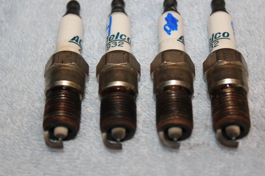

I'm fresh out of ideas on what to try to resolve this knock I have in my 2000 Tahoe 5.3L w/ 58,000 miles. As far as I know, everything is dead stock with no mods.
It seems to knock on hard acceleration and also when I pick up the throttle after "coasting" at high way speeds. If I keep the same throttle position, the knock will quiet down until I provide additional throttle. I do not get knock if I'm in neutral (ran up to 2,000 RPM).
No MIL or codes. No problems starting and smooth at idle. Minor piston slap for first 30-45 seconds on cold start.
Here's what I've tried:
- Replace both knock sensors w/ AC Delco 213-3521
- Replace knock sensor harness w/ Dorman 917033
- Replace intake gaskets w/ AC Delco (teal colored) & new intake bolts
- Replace fuel filter w/ AC Delco ACP GF652
- Replace EGR Valve w/ AC Delco 214-1080 & AC Delco gasket
- Replace spark plugs w/ AC Delco 41-110 Factory gapped
- Replace PCV valve w/ Purolator Part # PV1063
I have Seafoamed it using 1/3 can into brake booster, 1/3 can into fuel. I have run 3 bottles of Techron (two 10oz on full tank with Sunoco 87 & one 10oz with 10 gallons of Shell V-Power 93).
Changed oil to Mobil 1 with PureOne filter. Small amount of minor particles on drain plug magnet. There was a small sliver of metal in oil filter, but I'm pretty sure it came from the oil filter case when I cut it open.
Smoke tested it looking for vacuum leaks. Fixed mis-seated air intake on throttle body that was leaking.
As you can see, I've spent a small fortune on parts and time, so I'm looking for some advise.

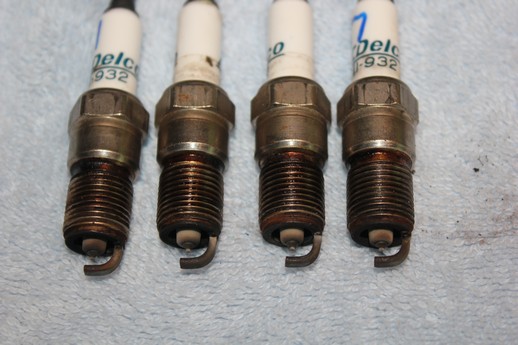

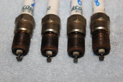

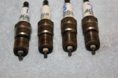

Attached are picts of the original plugs - they look good to me, but I'm not an expert plug reader.
