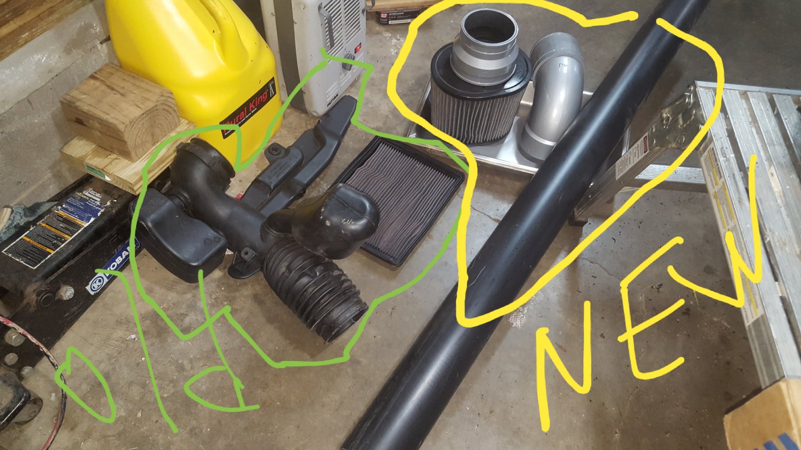

Well didn’t don’t any leaks in the intake system. Hooked up a smoke machine and the only place any smoke ever trickled out was the air filter. Nothing from the intake or the piping. Drove around and fuel trims were between -18 and -21. I reset the trims and it goes right back. Not seeing anything on live data to justify it pulling so much fuel out. MAF seems to be correct and adjust for throttle position. The one thing I couldn’t figure out was the PSI reading on the MAP. Is it supposed to be positive? Is it in relation to the barometric pressure value? I need to research this. At idle it’s around 5.5 psi and goes up with speed. But when I get on it the value still goes up. I would expect it to be high at cruise and a little lower at idle. But I also would expect it to drop when I get on it. No? Frustrating. Don’t want to burn a hole in a piston. Where to next? Thanks all.

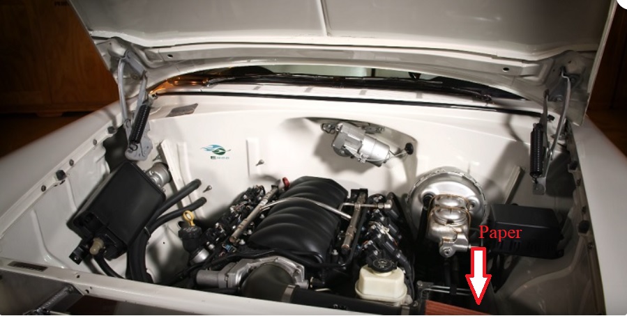

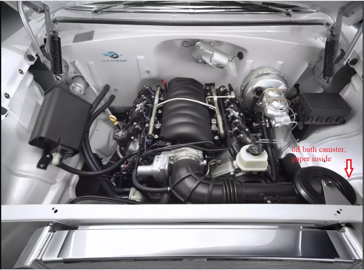

"New K&N panel with the excess oil wiped off." Is this a KN air filter? If it is, that is the problem. The programming is set up to model the air flow of a production filter. When you put the KN ones on, you need to adjust this model. Sometimes it won't even start like in the case of the 55 Chevy EROD I tuned for Chevy Performance.
Not true. That’s what the MAF is for, it measures the amount of air being drawn through the filter. It’s installed post filter, not pre filter. The only issue we have with a oiled filter like the K&N is if too much oil is applied and it gets onto the sensing wires of the MAF.
@Cj6706 when you say “excess oil wiped off” , how much oil did you apply? There’s a specified amount of it according to the filter part # and it needs to be the correct type, sprayed evenly onto the filter. There should be no excess to wipe off. If you are getting oil onto the MAF you’re going to have all kinds of issues.

Absolutely true. The MAF measures an electrical signal. Explain how it takes an electrical signal and converts to an airflow value. That is what the table does, and it is based on the flow of the filter. I did many of these in the car and on a flow bench at GM.
You can run an oiled filter on an LS with stock tuning tables just fine. There’s plenty here who do that. There’s also plenty here who remove the entire resonance chamber/ intake tube and install a cheap CAI with an even cheaper oiled filter with a stock tune with zero issues. There’s nothing needed to change in the tables to accommodate either one.
