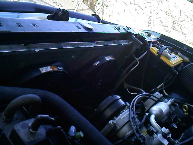

Could someone please post a picture of where you hooked up your A/C override on an Efan setup? If not a pic, then please explain which wire and what color it is, and where you hooked into it.

Are you looking for the wire that turns the fans on when the AC comes on? Hopefully you are not using the set up I used because it did not work for me.

What exactly didn't work for you?
But yes, my fans are pretty similar to what you have there in the pic. I have the fans working, but only with the thermostat probe. No override is hooked up right now.

It overheats after a while driving in the city with AC on. Mine come on when the AC is turned on or thermostat kicks them on.
---------- Post added at 01:38 PM ---------- Previous post was at 01:35 PM ----------
I had these on my 95 silverado for two weeks and did not work. Rag got caught on my fan while wheeling the tahoe so since i had these lying around I thought i would try them on the Hoe but no luck.

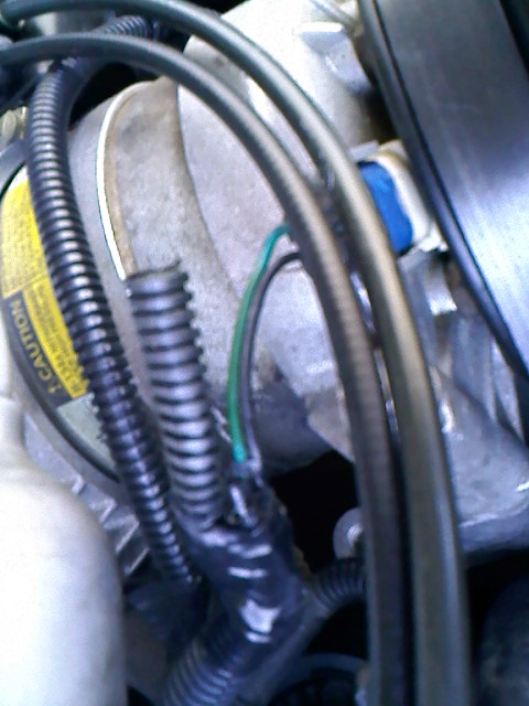

so which wire did you use to hook into the AC unit? I couldn't tell from the pic?
My fans are dual 2100 CFM fans. I think they'll do ok, but we'll see for sure after a few days of driving.
wicked2000
Jan 25, 2010
96
El paso TX
Let me know how they work for you. Its the green one.
