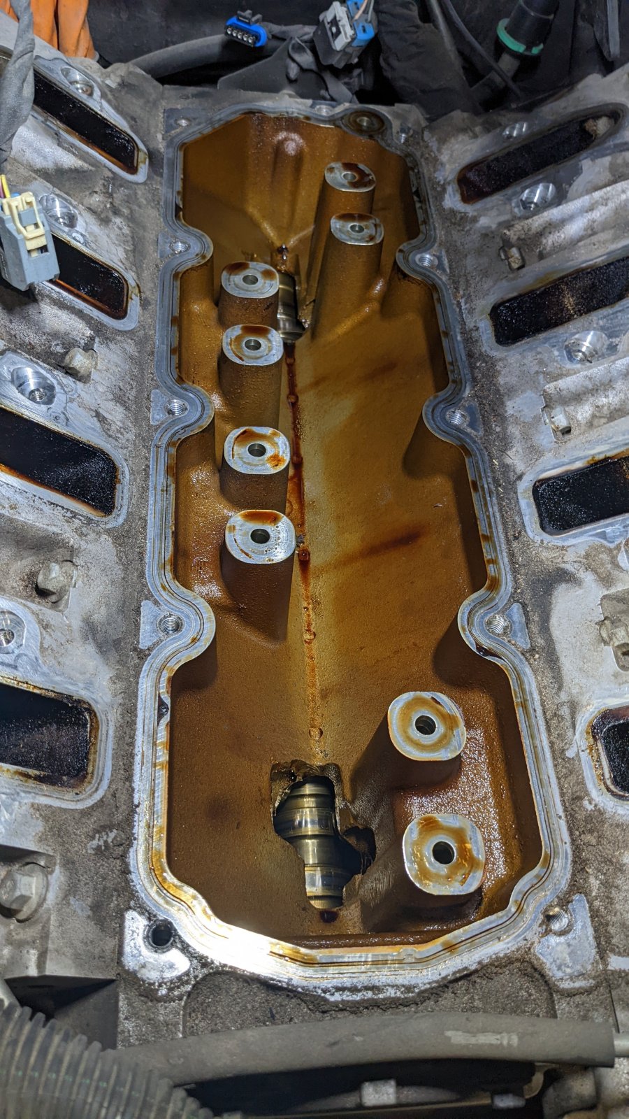

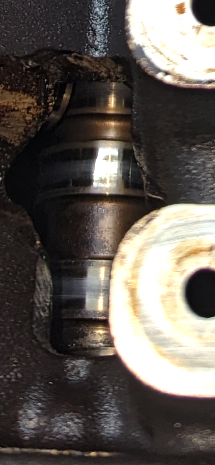

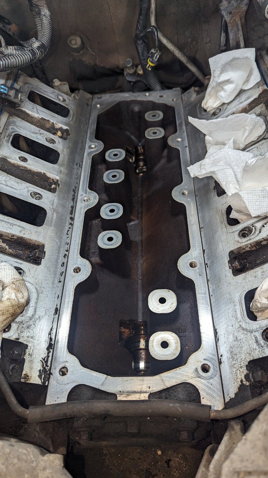

So here we are. I decided to do the valley pan first. I'm glad I did. Every bolt on the valley pan was loose
Absolutely no socket wrench was needed. Every last screw was unscrewed with my fingers. I used a pry tool and patience to get the valley pan up. Every last square inch had black sealant around in. All o rings and seals are absolutely shot. O rings were so old they were cracking and splitting. The gasket was stuck to the block. And the hole that holds the oil pressure sensor and filter on the inside of the valley pan was absolutely disgusting. I will have to reassemble everything and see if my oil pressure changed before I decided to replace it this weekend. But for now I'm cleaning everything.

wow that's ugly.
almost all bolts are loose on the valley covers. I don't know what gm was doing with tq apec on these things.
but on good note this well he an excellent experiment to see if leaking back thru the lifter thru the vlom ports makes much difference in the oil pressure.

I am also wondering if my oil leak will minimize as well. I just wish I knew why the previous owner went through the trouble of removing the intake and sealed the edges but didn't replace the gasket. I was told the valley pan didn't need sealer around it. I was contemplating using some extra gasket maker on the edges.
j91z28d1
Feb 28, 2022
3,563
4,404
I don't believe it needs any sealer, I had mine off to snip the gaskets around those oil holes. didn't even replace the gasket. it all looked good and hadn't leaked any.
