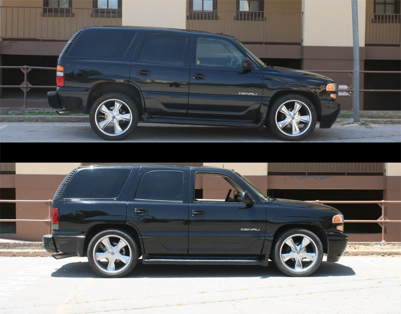

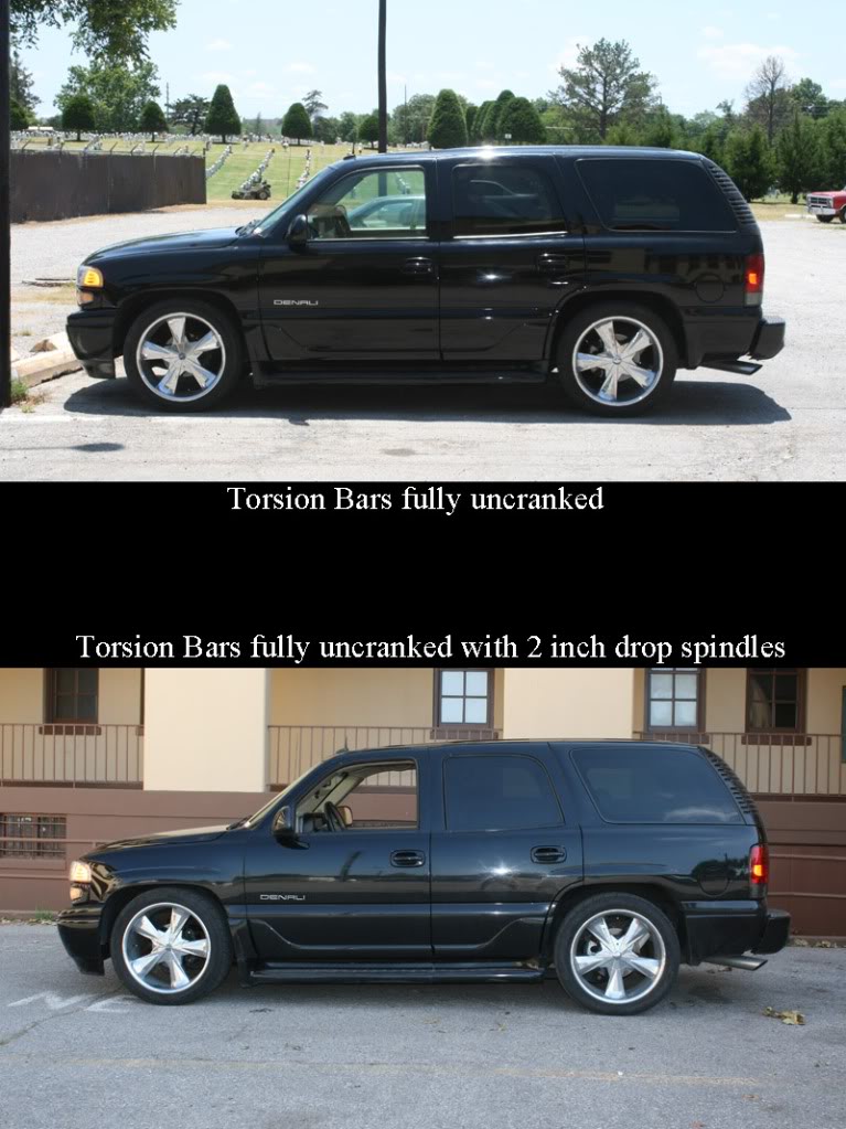

This thing handles sweet! I like it...it does bounce though in the back now...like a cheaply lowered civic..but only on bumps and dips...but cornering is very nice...still needs to go lower though... the isolators aka rubber pads on top and bottom of spring arent that thick anyways so it wont make much of a difference...I still need to install the 2 inch drop spindles and keys...everything up front is stock, I just undid the torsion bars all the way...
hmmm...how to get the back 2 more inches? (without a body drop...thats extremely expensive)
