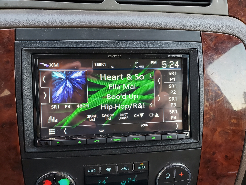

My Rosen GM1210 did the same thing. I upgraded to a Kenwood and am very well pleased.
FYI there is a company on ebay that will fix the Rosen. I contacted them and sold them my old Rosen for like $90.

I went with the DNX575S and love it.
