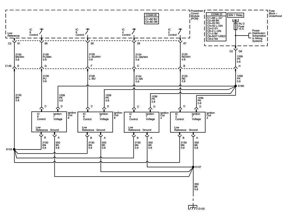

Theres quite a few grounds and hots that would cause just 2,4,6,8 problems. The wiring harness to your 2,4,6,8 coils get a ground at splice S157 to G102. Check your black wire at each plug of your coil, check resistance to ground. Should be low at each coil. Also check each pink wire for 12v at each coil plug. All coils are fed power from your INJ2 Fuse and so are your injectors for that side. Your coils are fed via a splice (S160) via the INJ2 Fuse. Check that fuse for 12v both sides to rule out corrosion on the fuse.

Thanks DodDel, I'm just curious, since the engine has a single camshaft wouldn't a cam timing issue affect both banks equally?
