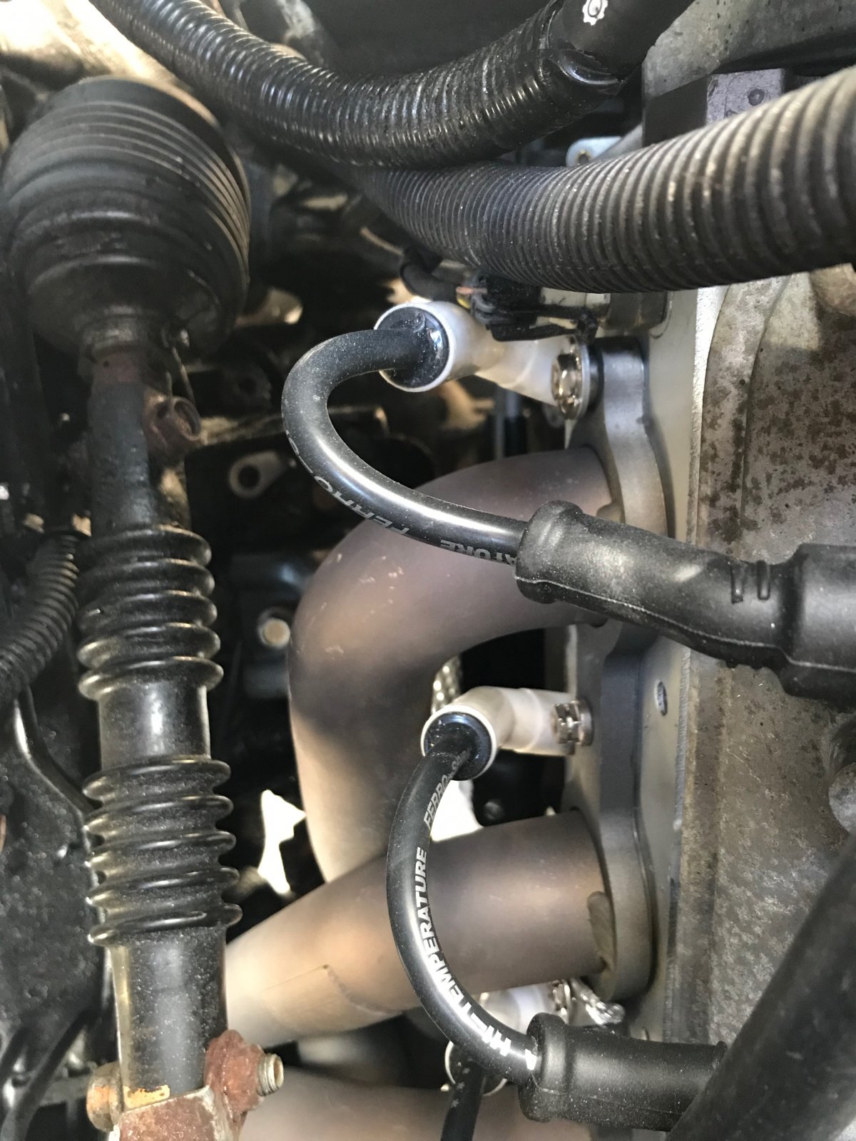

Thanks for all the info guys. I suppose I could also wrap the headers, since they’re not ceramic coated. I’m trying to do this on a very tight budget.
Sounds like the high temp Taylor wires are the best plan, maybe combined with the socks. [emoji106]

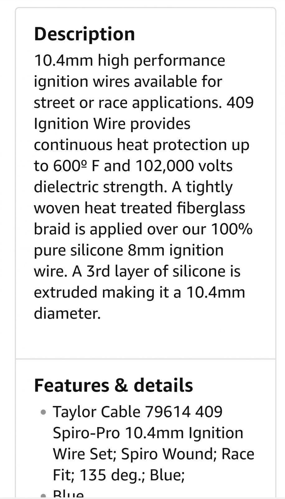

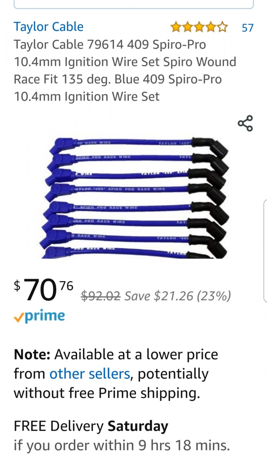

Thank for the info, how about putting sleeves on the whole wire? could secure them with metal zip ties as when wrapping headers. I also have ceramic coating on my headers,hoping won’t run in to this issue.
https://www.amazon.com/Design-Engineering-010475-Titanium-Technology/dp/B00YJG5Q1O/ref=sr_1_20?crid=2B07FBOAOAQ7F&keywords=spark+plug+boot+protector&qid=1552326356&s=gateway&sprefix=spark+plug+boot+pr,aps,433&sr=8-20&th=1
I ended up using the Taylor wires with their sleeves. So far so good.
