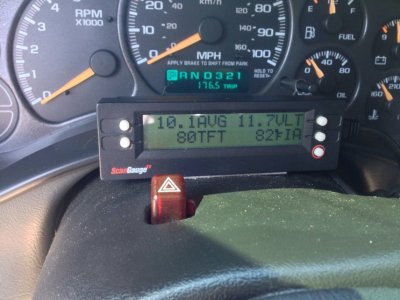

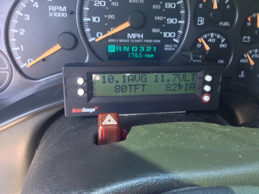

Sorry I forgot to update this yesterday. I got what I wanted done! The Denali cluster I bought ended up being a new cluster so I was able to program the miles at work so I just swapped the Escalade bezel onto it. I didn't try and do any reprogram on the stock cluster to try and get the trans gauge to work though. I programmed the Denali gauge with the right program for this Tahoe and the trans gauge still works so the programming it needs might be internal to the cluster. Here's some pictures:

WOW! I like that a lot!
Did you try checking to see if the tranny actually has a temp sensor in it already? I would start from the sensor and work my way back before I blame the gauges.

Chip these transmissions have temp sensors inside it. When i bought my truck I took it to my tranny guy and he hooked up his big fancy reader to the truck and we took it for a drive. He checked the shift pattern tranny temp and fluid pressures. All were in spec. So I know these have it built in.
