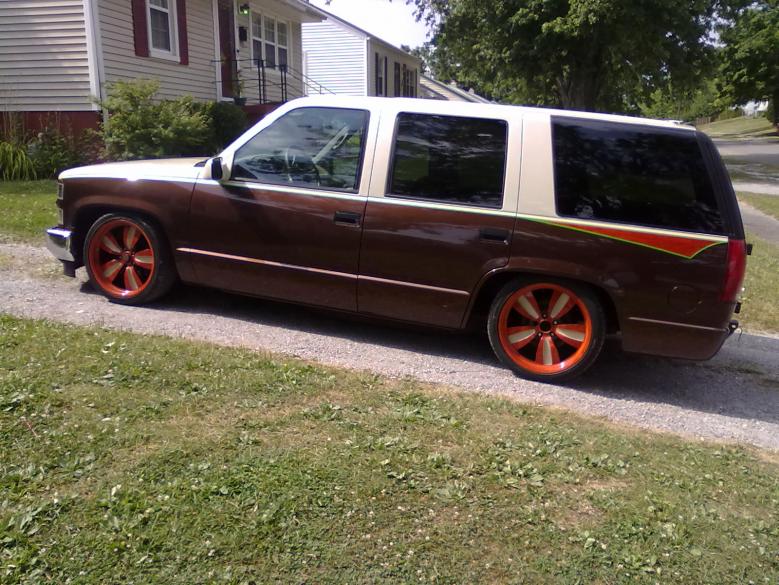

2wd dropped 2/4 with springs up front and shackle hanger kit in the rear. Was running 24" U2-85 with 295/35/24 tires(rubbed to much). Now Gino 498s with 255/30/24 Nitto Invo tires.
