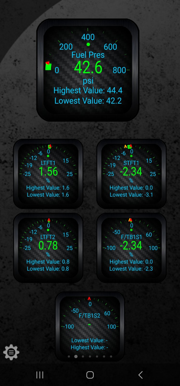

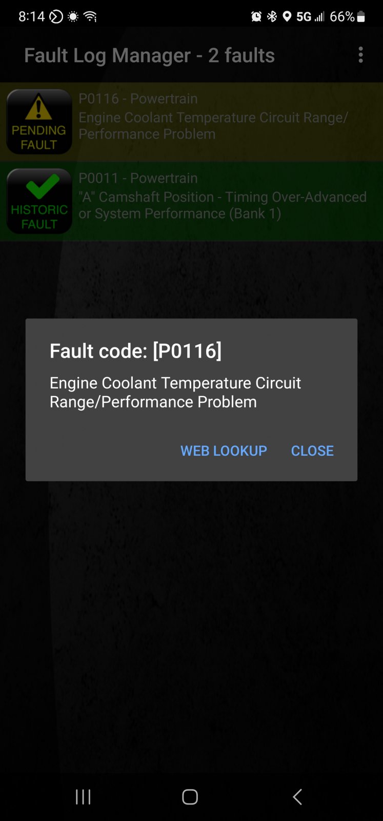

Not that it means anything but I ran Torque Pro and here are the results. Everything was ok except all the EVAP stuff. I also ran the data on the Fuel Pressure/Trim Sensors. When it was idling while the test was running, it seems to sputter a bit. 2011 Denali XL with Flex Fuel

Has it run an evap drive cycle, or have the codes been recently cleared? Had any prior trouble with the evap system?
I'm with @iamdub, either a leaky injector or a stuck (or intermittent) purge valve on the engine. Either one could dump some fuel (or vapors) into the engine, causing a crank-but-no-start condition.
For the evap, have a purge and seal test performed. For the injectors, test for injector balance and leakdown. Those are standard tests with a good bidirectional scanner.
