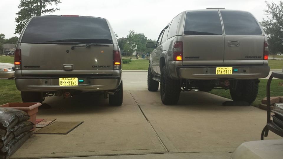

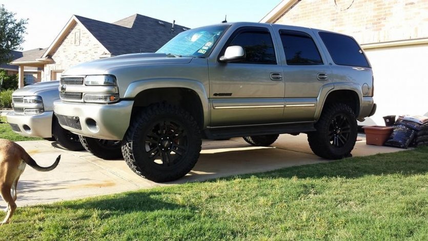

Wife's 2002 Tahoe LT Barn door

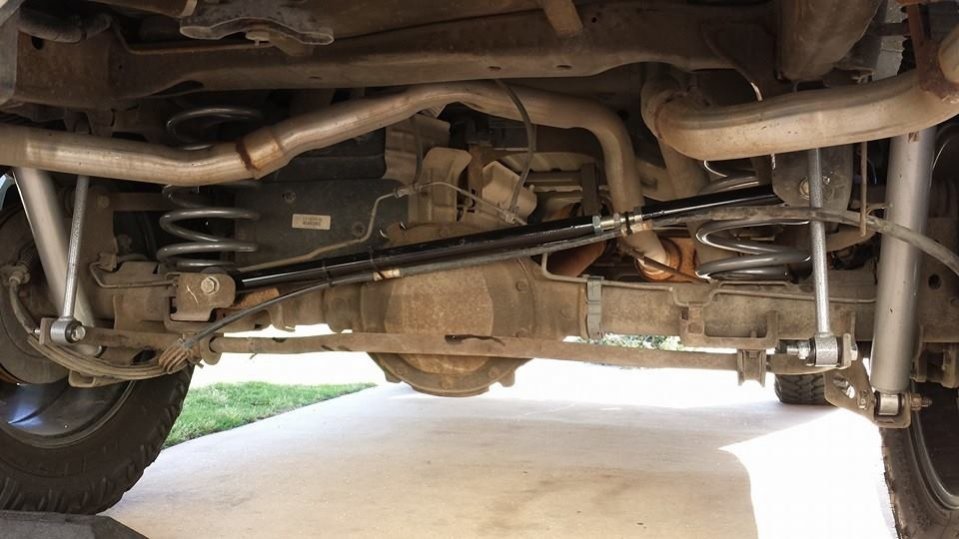

CST lift spindles and pro comp level kit ( not cranked at all! ). Six inch rear springs and drop sway bay links upgraded pan hard bar. G2 4.56's gears and a eaton ratchet locker. Running 35X12.50R20's. I also replaced the UCA's with Moog and the hubs with Timkin and new idler , pit men arms! Runs and handles great no regrets. Got the spindles from another member on here for $150 shipped! Now the tires dam near killed me Nitto Trail grappler M/T's
