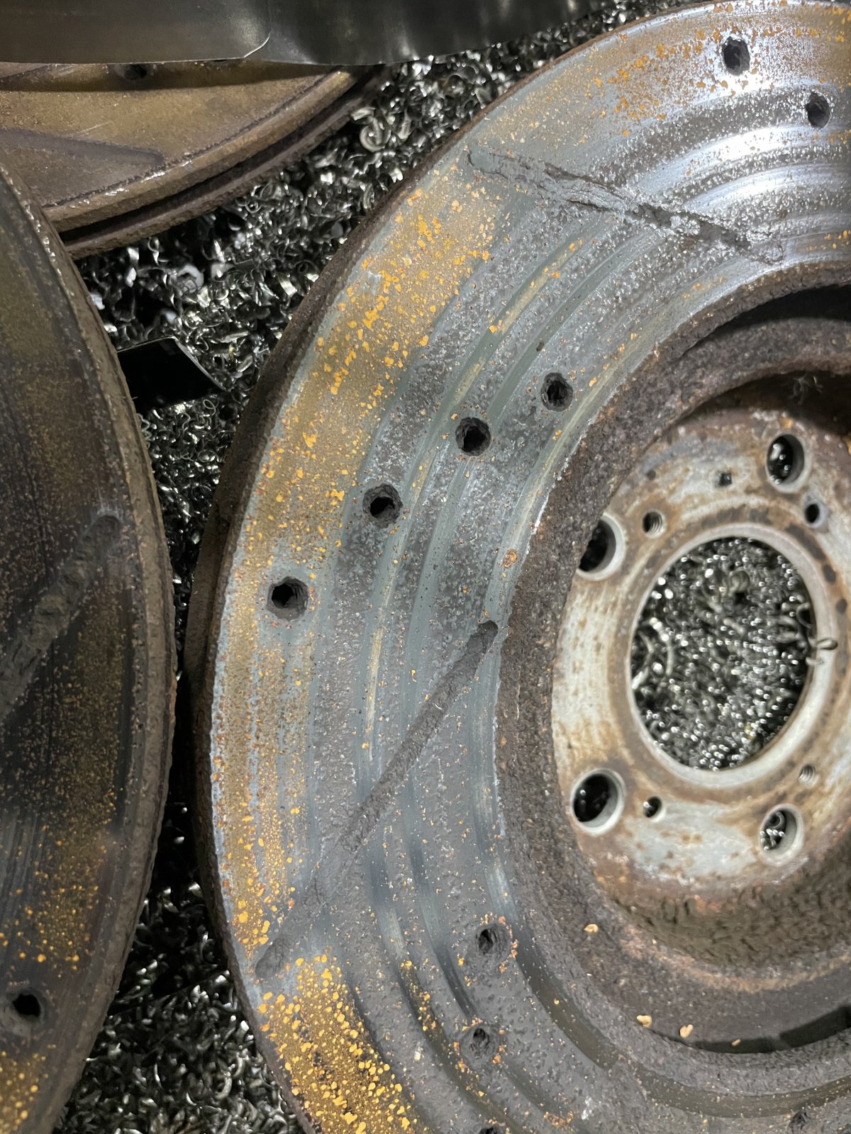

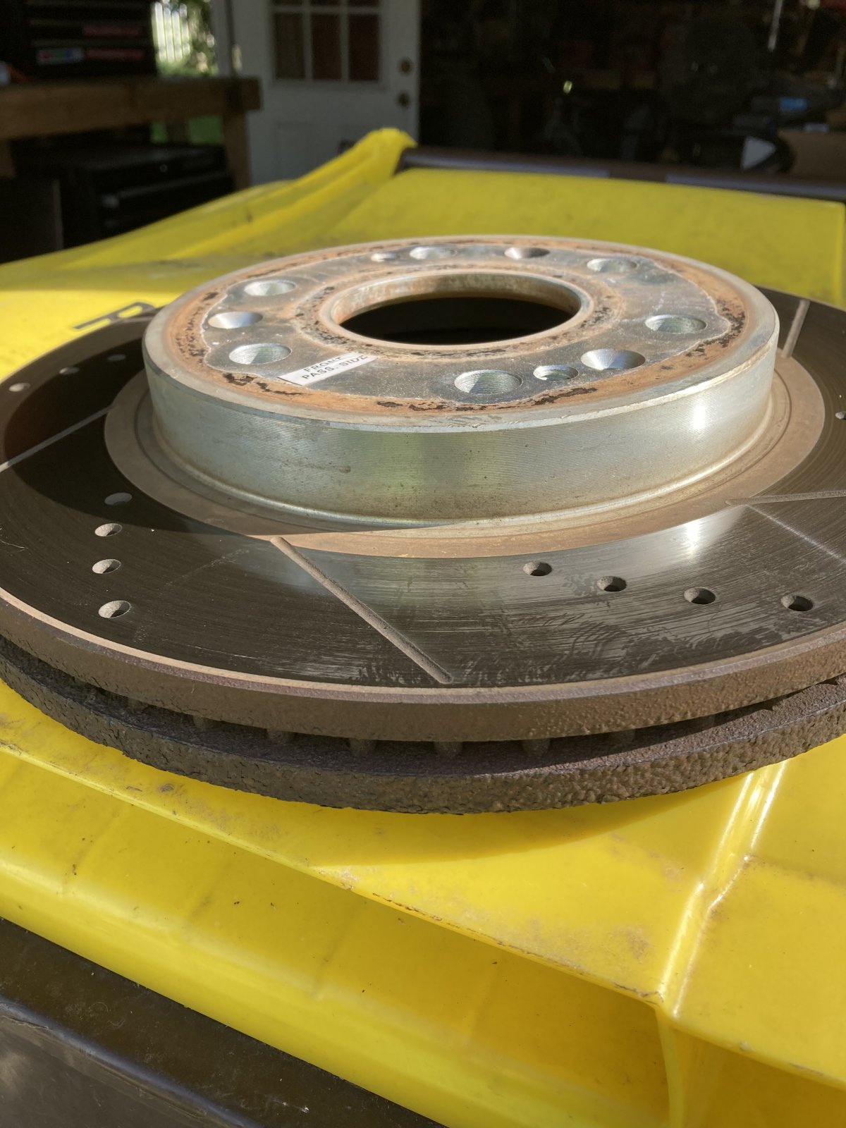

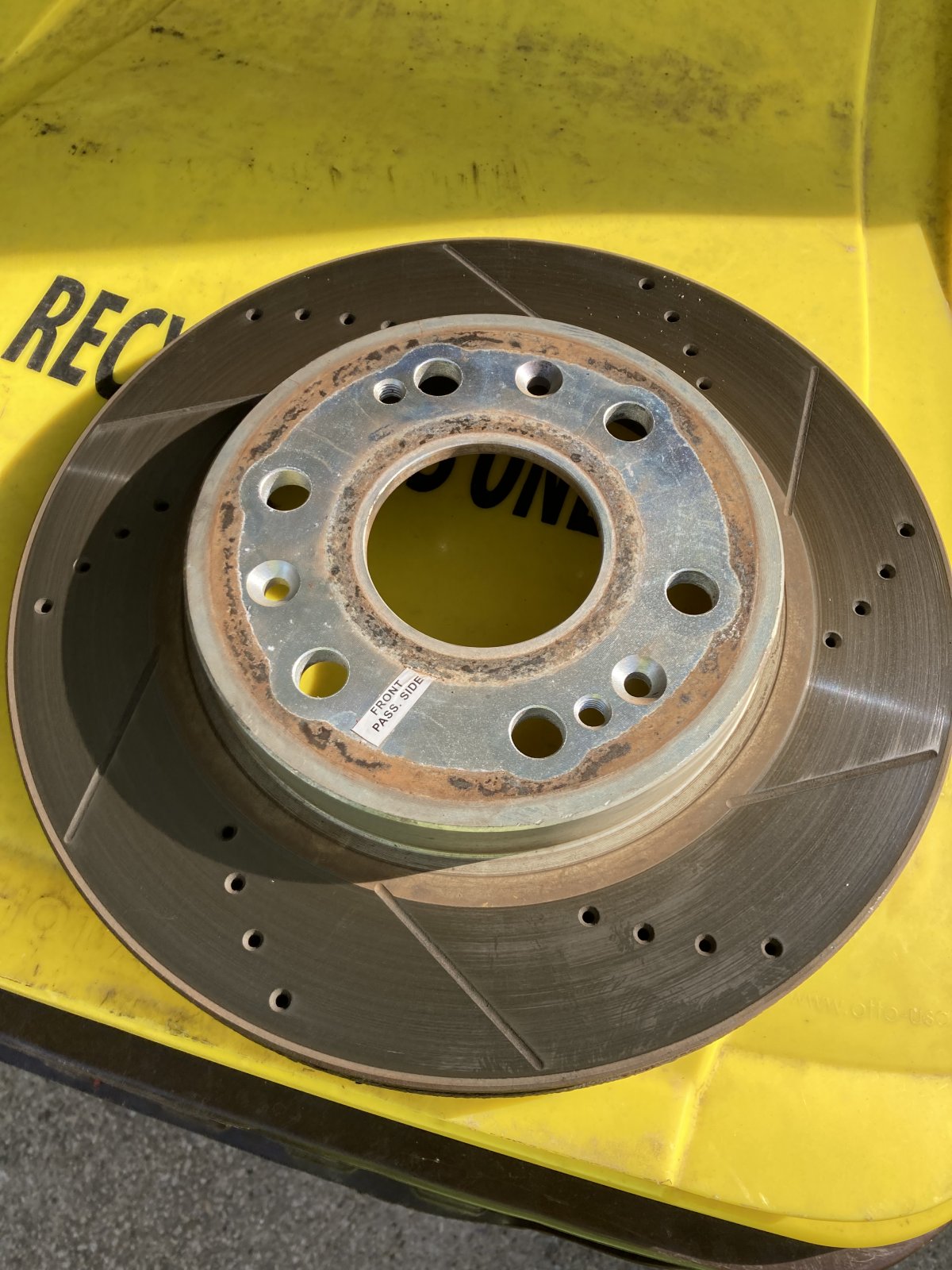

Yes. However I replaced all the calipers a year ago, and now I have a rear rotor taking a crap in the same fashion. Just sharing my experience, not trying to be a negative Nancy.
Do you think the harsh winters and salt have an impact on the drilled rotors more than the smooth ones?
27,793
42,226
rotors are steel they will develop rust in hours of just sitting even here in ca where they do not use salt or anything.
George B
¯\_(ツ)_/¯
Feb 5, 2020
7,826
18,764
Oconomowoc, Wisconsin 53066
I agree but around here it is a different level of rust. Stuff gets ****** fast! It's like any pit in the surface turns into a ridge around the rotor super fast. Here are some that are in the scrap bin today. I am not saying I wouldn't run them but I wonder if the life expectancy would be lower around here. I think @89Suburban has experience.
