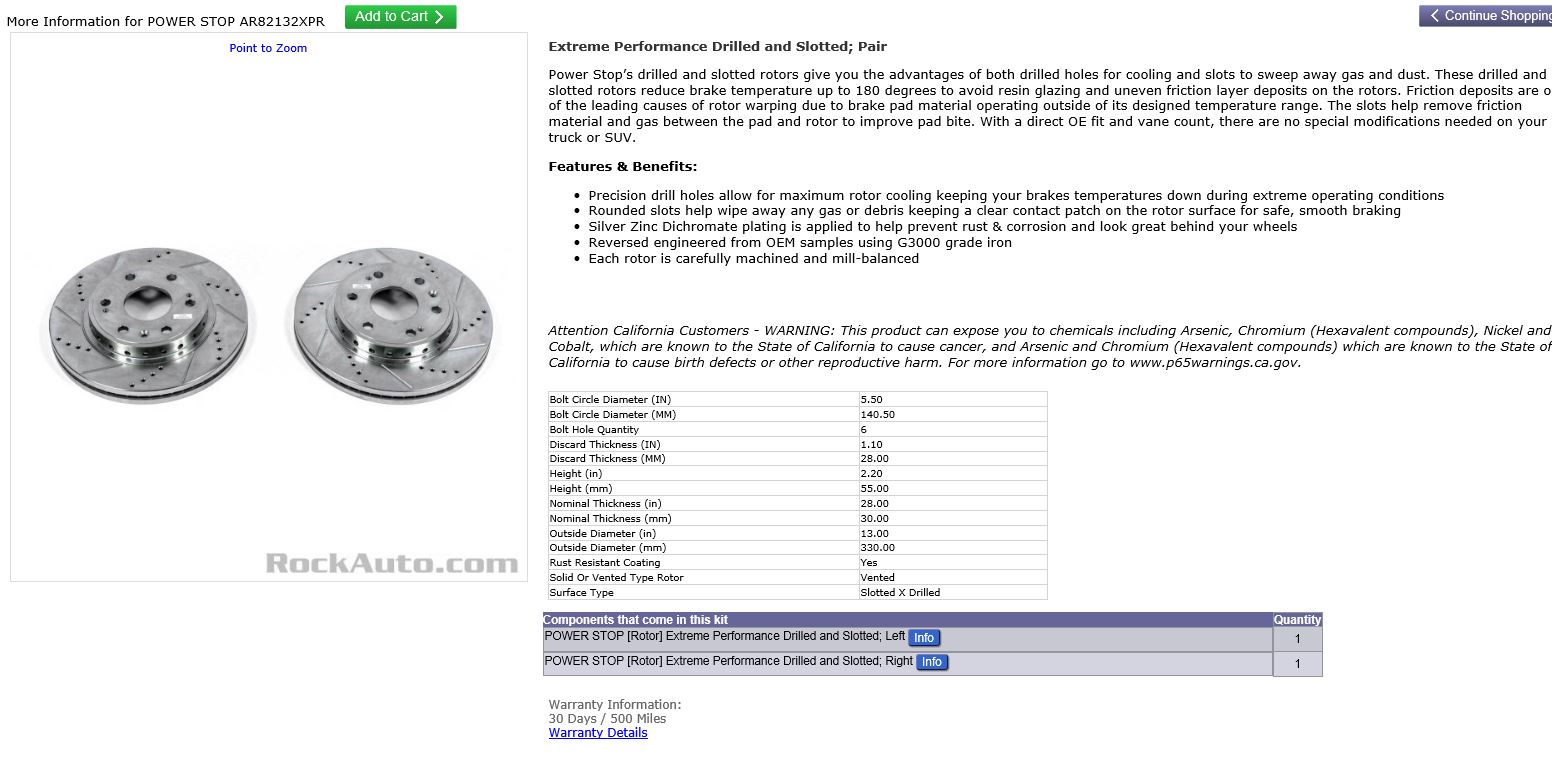

27,683
42,072
this set will run you about $450, can't beat it unless you go up to a big brake kit
most of your other brake calipers out there are "remanufactured"
even the powerstop rotors are from "oem samples"
