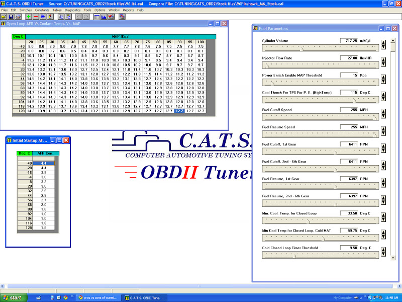

Just to clarify, when the engine is cold, more fuel is injected into the combustion chamber as the fuel can not completely atomize. This extra fuel is injected to ensure enough fuel will be burnt to create the required amount of combustion chamber pressure required to make the engine run, smoothly.
The PCM will command a richer mixture until the defined CLOSED LOOP temperature is met. Once the vehicle hits this defined temp, closed loop will begin and the PCM will adjust injector pulse width based on O2 sensor feedback to achieve 14.68 air/fuel ratio, which, is best for emissions..... Some of you may have experienced your vehicle runs great until it warms up and then it runs like crap-thats a bad O2 sensor most likely. I think everyone has hit valid points here. So....there are different things to consider: comfort-let her warm up; gas mileage-you're getting ZERO when its idling; wear and tear- 0-1 minute idle warm up and then drive like a grandma until you hit closed loop.
Heres some examples of what the PCM is commanding. This was from a 96 LT4 Vette.

I really don't think he has any idea what exactly he's talking about. Well, moreso, why it does what he is talking about.
Engines will naturally run leaner in colder environments. Colder air is denser air. This leans your car out, which the computer will automatically adjust for(add/pull fuel, advance/retard timing, so on..) it will add fuel to basically put the air/fuel back where it is commanded to be.
They do NOT richen themselves up to warm up faster though. Most fuel injected cars will automatically increase the idle upon startup, until it is warm.
When you add MORE fuel, it actually has cooling properties and makes for very slightly cooler combustion temperatures. so: A car running rich will have a cooler combustion temperature. That's where most of the heat comes from on your motor; combustion heat. The other portion is from the friction of moving parts.
So say on a given 60* day your car is running a 13/1 Air fuel ratio. ON a thirty degree day, your car may WANT to run a 13.4/1 air-fuel(leaner). your car will add fuel and timing to make itself run the commanded 13/1 ratio(it will not richen itself past the commanded A/f), and the added/pulled timing will keep it from preigniting, detonation, knocking/pinging. The same amount of air is going inside, it's just denser therefore there is basically more USABLE air per cubic foot. the engine will add fuel for that extra dense air coming in.
Now if you just got bored and decided to say...add fuel for no reason via a tuner. A. it will richen it up past the commanded A/F and B. it will lower combustion temperatures slightly.
Some tuners will actually add fuel to richen it up just a little to prevent Short-term knock, which can allow them to tweak the timing just a little further(so they can tweak the extra power out of the motor.) Too much timing, and detonation can become an issue. too little can have adverse effects as well. The extra fuel helps cool things down and prevent pinging aswell.
Just trying to clear the air that the added fuel upon startup in cold weather is NOT to warm the engine up faster. It's to compensate for the dense air.

no, he's right.
They do command more fuel (and a target ration OTHER than 13:1) under cold engine temps.
This is because it is LESS efficient when cold, as the tolerances are greater and counter intuitively, so are temps. Stoich has to do with EMISSIONS not power. Power is about 12:1.
remember, we are talking about engine temps. NOT air /external temps. What you are talking about is barometric compensation which happens constantly, we are talking about Open loop warm up, which only happens when the coolant temp is under 90C
Adding fuel PAST peak power decreases temps (which is why you see some turbo cars with 11:1 or 10.5:1 under boost and high rpm) due to heat absorption by the unburned fuel. Adding fuel up to ~12:1? Increases combustion temps.
with the prevalance of front widebands you can actually run closed loop (& non 14.7) under non steady state conditions. Otherwise the only time you are using the o2 sensor is under steady state (cruise).
