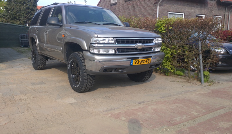

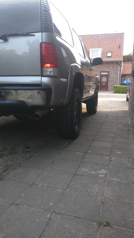

I got about 2.5"+ of lift. I run 285/75/r16 MT's with no rub.

If you crank the keys all the way you should be ok. Might rub a little. Are the rough country shocks longer than stock up front? Also, are you not leveling the rear? Theres' probably enough room in the rear wheel wells to stuff 33's, but your truck is gonna be leaning if you don't bring the rear up too

That sounds right.
Here is what you need...
Front shocks: Bilstein (24-186643) 5100 Series Shock Absorber https://www.amazon.com/dp/B00BYNJAVW/ref=cm_sw_r_awd_m-R-ub1HW0M01
Rear shocks: Bilstein (24-185783) 5100 Series Shock Absorber https://www.amazon.com/dp/B009FU66FO/ref=cm_sw_r_awd_baS-ub104YG2C
Coils: Moog 81069 Suspension Coil Spring https://www.amazon.com/dp/B00498ZR7A/ref=cm_sw_r_awd_YaS-ub1K4D3TH
Keys: 1" - 3" Torsion Bar Lift Keys Chevy Half Ton 6 Lug 4x4 Trucks https://www.amazon.com/dp/B00BEN1PXI/ref=cm_sw_r_awd_QbS-ub103YDWK
Spacers: 1.5" Lift Rear Axle Coil Spring Spacers Tahoe Yukon Suburban https://www.amazon.com/dp/B00BEN3BEY/ref=cm_sw_r_awd_LcS-ub0YPNVHA
