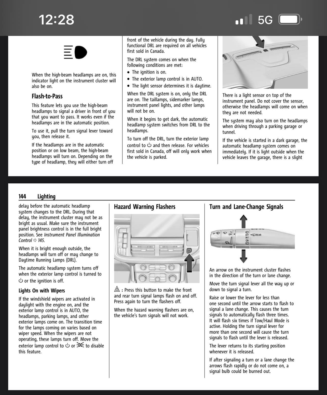

They gave me the same load of crap. Tell them to point to where in the manual it says the automatic lights are supposed to come on in bright light for safety reasons.
I told them it wasn't working as per the manual and there was an error code so they needed to replace it. They did, begrudgingly, even saying it "wouldn't change the operation" but replacing the sensor 100% fixed the issue. Lights are now off and DRLs are on in bright sunlight.

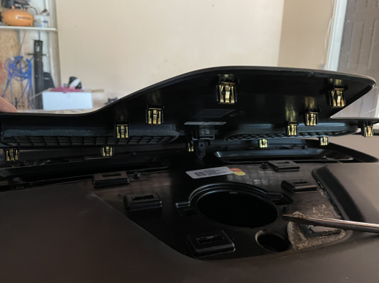

Just replaced my sensor in less then 5 mins and it fixed the problem.
Take a screw driver or something flat to pry up gently on the panel. Once you pull panel up remove the bad sensor. There are a couple of plastic clips. Just push them in. Replace the sensor and push the panel back in the clips.
I am not a certified GM Technician and it was easy to do. Do at own risk.
