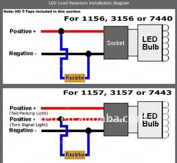

QUESTION: Resistor wire up to front parking light and turn signal

I'm putting in LEDs into my parking lights and corner lights on the front. My question is do I wire in my resistor into the blue or the brown wire? In the parking light socket there's a blue, brown and black wire. In the corner light there's just a brown and black wire. Obviously, the black wire is ground so one end of the resistor wires into the black wire but does the other end of the resistor wire into the blue or brown wire?
Thanks in advance for your help! :waytogo:
Just wire the resistor across the Signal wire for turn signals and ground. If i remember correctly, its the blue wire. you can put a test light on the connector for that wire with the turn signal on. If the test light flashes.....welll ahh Magic! :yaoface2:

ANSWER: the correct wire to wire the resistor to is the blue/white wire that goes into the turn signal :waytogo:
