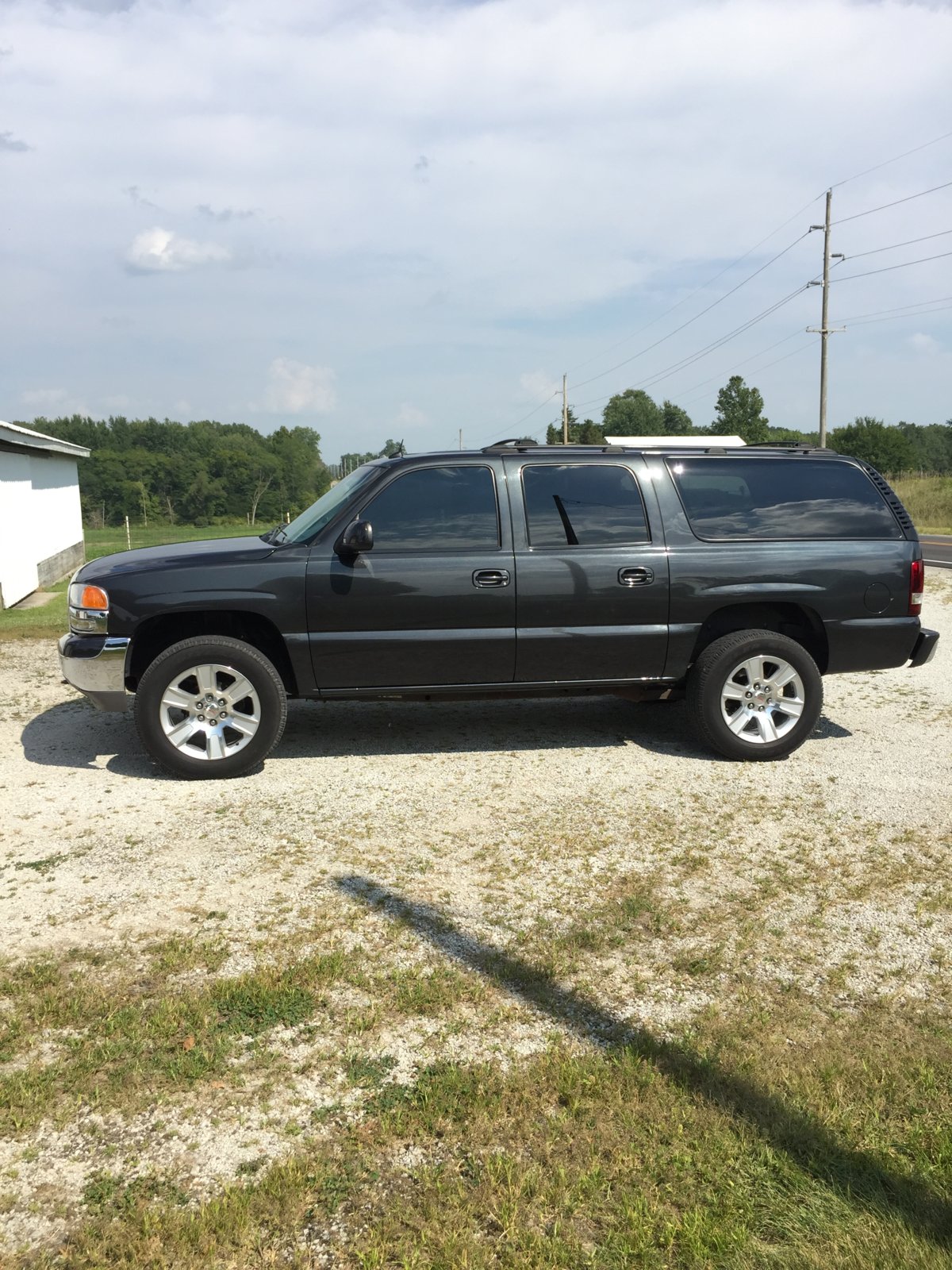

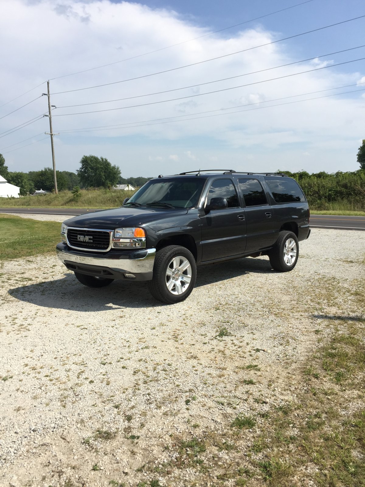

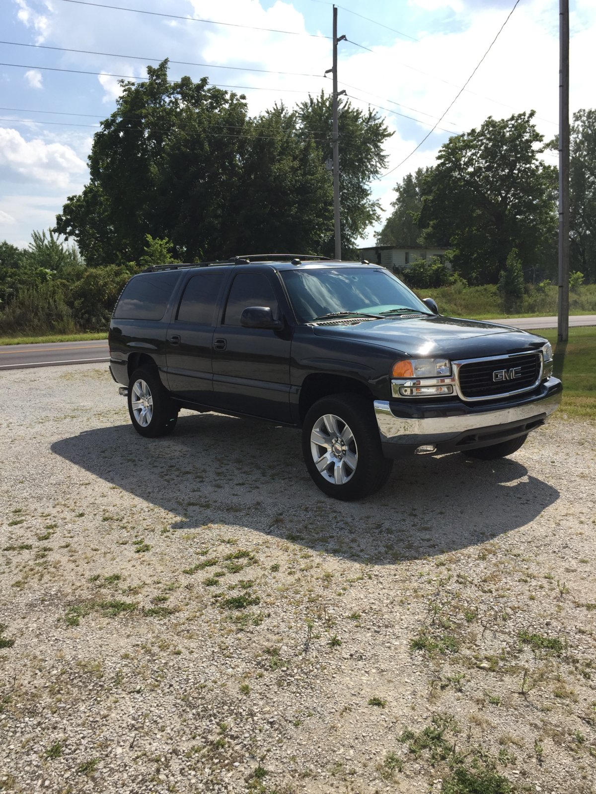

EBay keys, 1.5" coil spacers, and Bilstine 5100's and the ride is pretty much like stock, just a bit firmer. As long as you don't crank your keys to the max, angles won't be terrible and ride will be close to stock.
Another option would be completely stock suspension and throw on a 1.5" body lift for a little extra height.

Countryboy mind posting a picture of your CV angles and also a side shot of your rig to see the 1.5" spacers to fender distance better? Beautiful rig but I'm not sure if I want 2" spacers with flares or 1.5" spacers without flares. Guess the deciding factor is if I can fix the light bubbling of rust I got on the fender lip lol
Does anyone use extended swaybar links? I think thats often over looked or not talked about.
