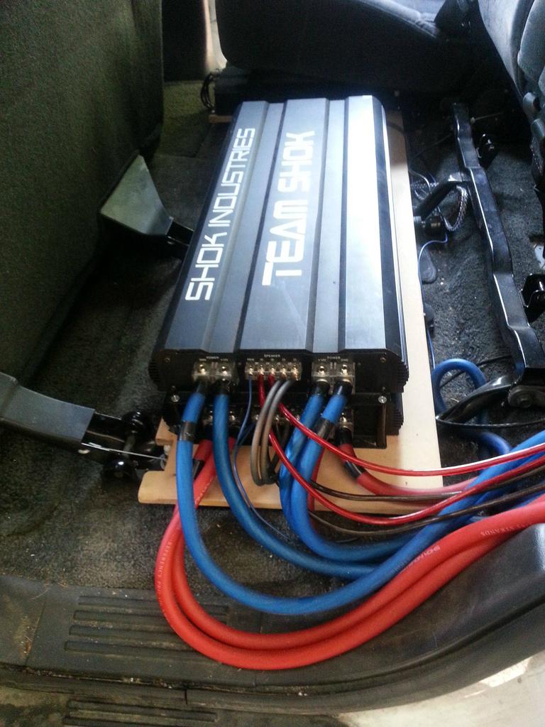

Might as well update this thread instead of making a new one. Few changes, I got a bigger amp its a Digital Designs m4a, its rated 5900 at 11.9v at 1 ohm. I'm running it at .5 daily.
People have clamped 7-9k out of theirs, very very underrated. Im in the process of deadening my roof and I have a new box in there its 16 cubes tuned to 38hz with 256sq inches of port, everything is rounded over and subs are flush mounted. The box is getting painted when I get some time to pull it out.
