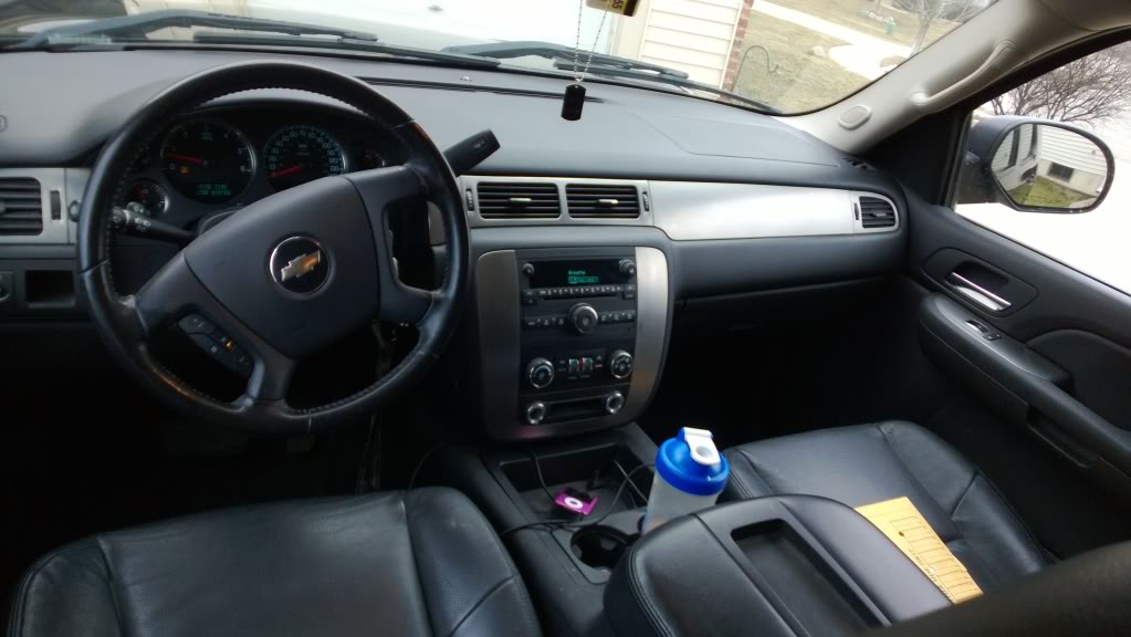

As far as I can recall, any vehicle that has the dash in the first photo (AN3 or A95 bucket front seats) will already have the DIC switches... Any vehicle that doesn't have that will have the wiring hiding behind the blank panel on the drivers side.. I've only replaced them on Sierras, but it's always been plug and play...
Which dash do you have? Pics?

Heres a pic of my dash..Best one I have at the moment so idk if it helps much but here it is....A95 is in my build codes also

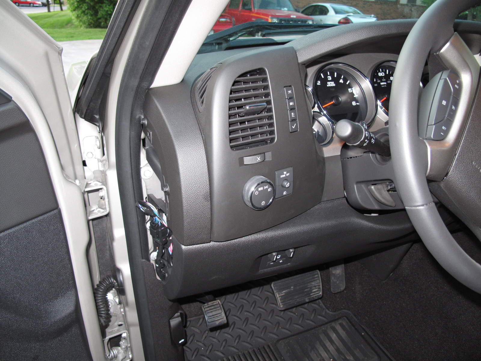

Here's a pic of a PPV dash that shows the spot:

and in that picture the spot that your talking about it the one to the right of steering wheel and left of the center vents correct?

Yup yup, right next to the vent speed roll thingie.
