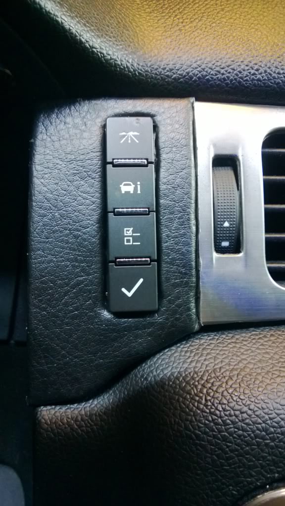

I just bought the DIC switch and plugged it in to my Tahoe, works flawlessly :)
However as my native language is not english I'm having difficulties tracking down the dash replacement part I need to make it look factory. I looked into customizing the original part, but as far as I can see it will not be possible due to the offset needed to make the buttons flush to the cover.
Anyone know?

When I removed the dash trim, the connector was already there, fully functional. It was in a placeholder bracket at the back of the actual trim so I just loosened it and connected it to the switch.

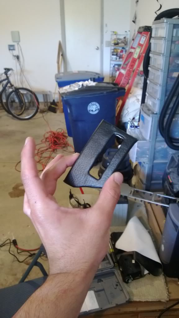

So I just took the DIC buttons out my friends 12' suburban and plugged it into my harness and it worked!
