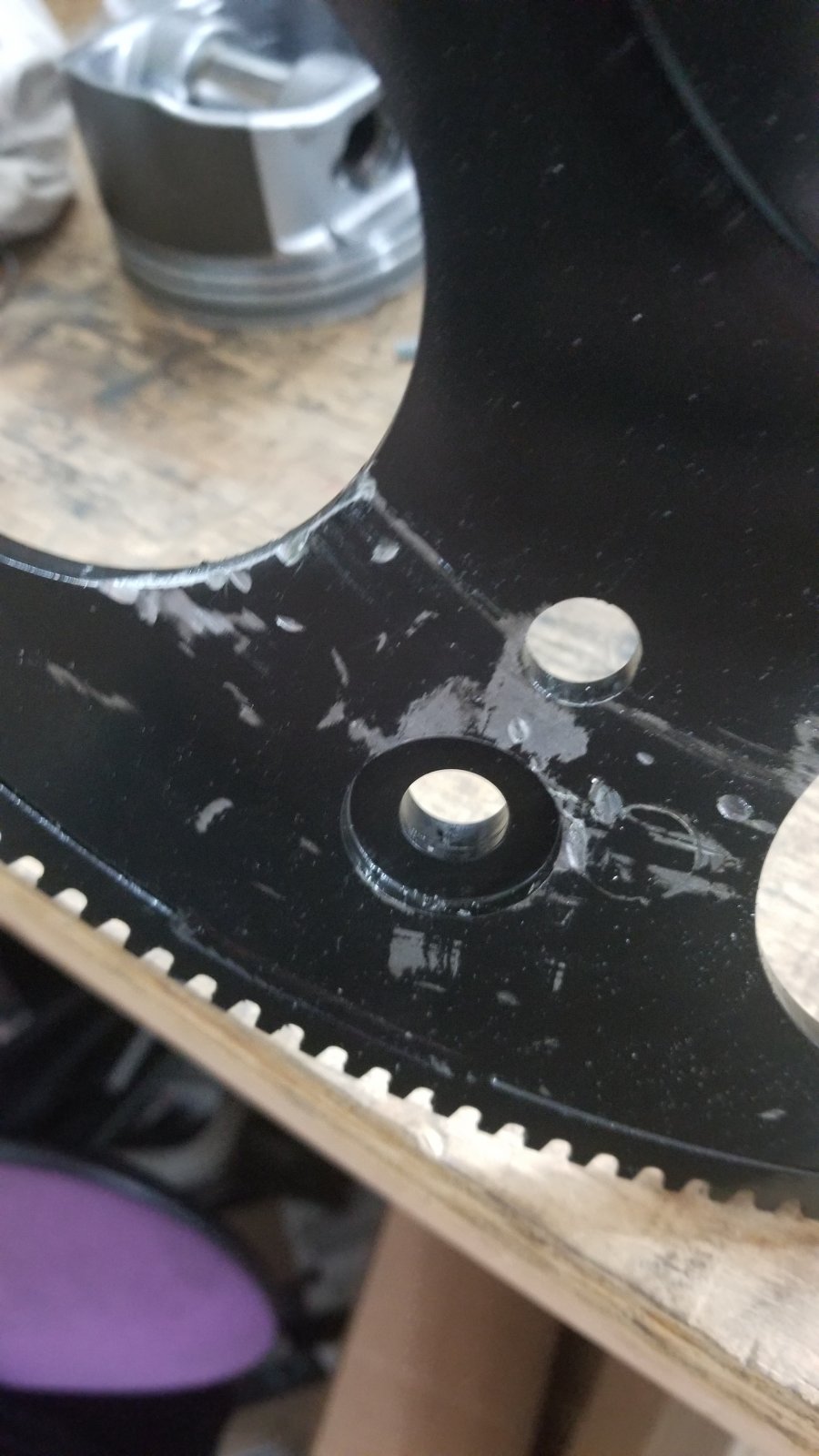

Line up yer dots, I have a flex plate lock I throw on it at the point, pull tensioner back and put pin (small drill bit) in and take it off. And of course why would all the bolts come back out easy

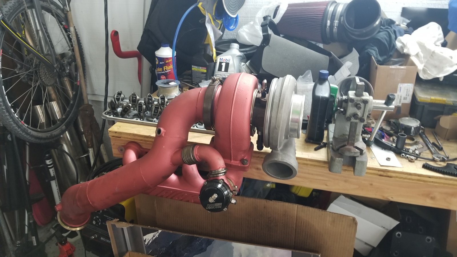

Are you changing timing chain tensioner? Just wondering when I was doing VVT delete my kit came with old style tensioner as on the pic.
but after installing it we noticed much play in the chain, so went back to original one.

you mean tensioner 1 or 2 of the ones you posted? the top one i wouldnt even call it a tensioner it just keeps the slack from going in
i'm putting back on the spring loaded one

Picture 1 on my friends truck making noise, I went with picture 2 no chain noise for me
