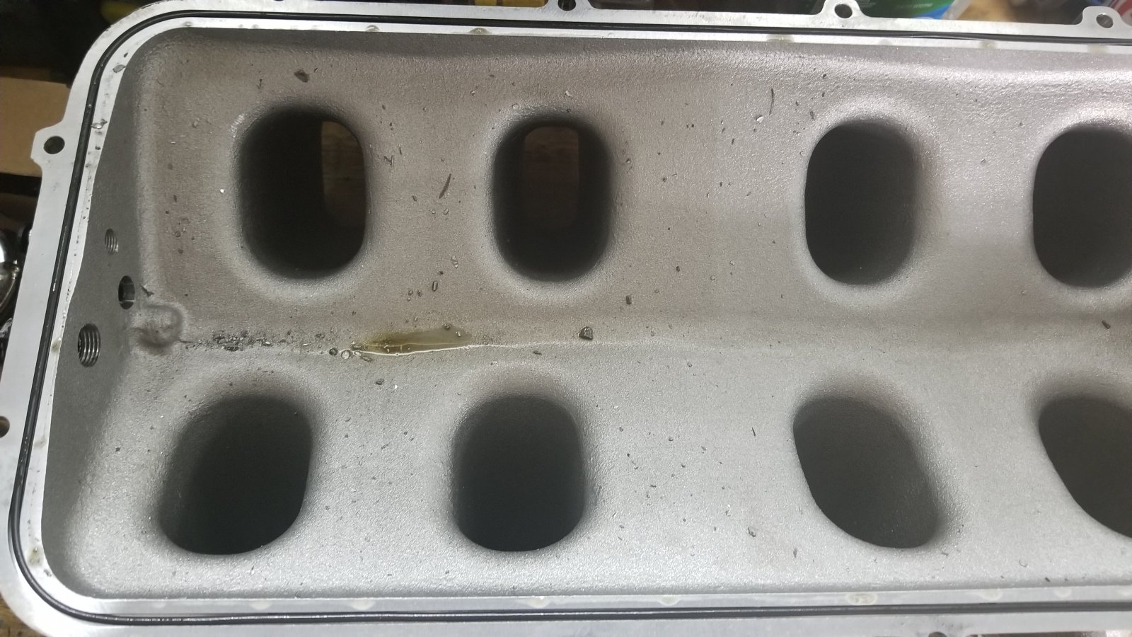

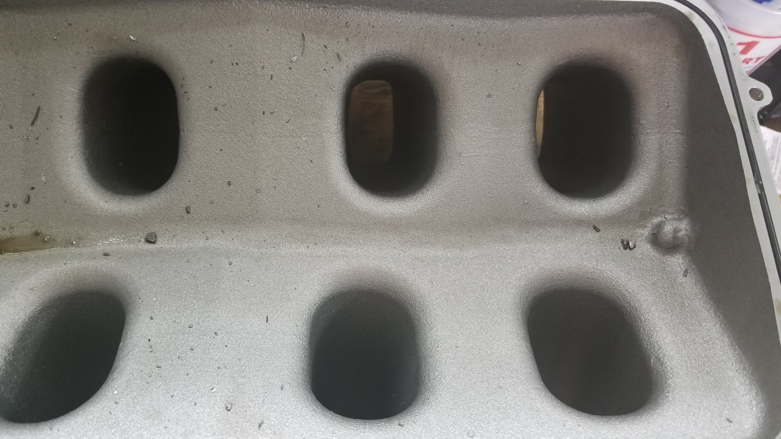

As for oil pressure now...I beat it pretty bad, after afm delete the towers are left open and just the valley cover has orings but not much support to seal up well (going to tap plugs into each) . Oring on pickup tube looked great and was tight but it's an easy swap why not. I removed the oil galley plug right after the oil pump on side of block and have 4an line going to turbo, it's a thrust bearing style so it should restrict oil flow and allow pressure to build no problem. Plugging pressure relief in pan, and only other major place ol pressure could drop is the cam retaining plate.
