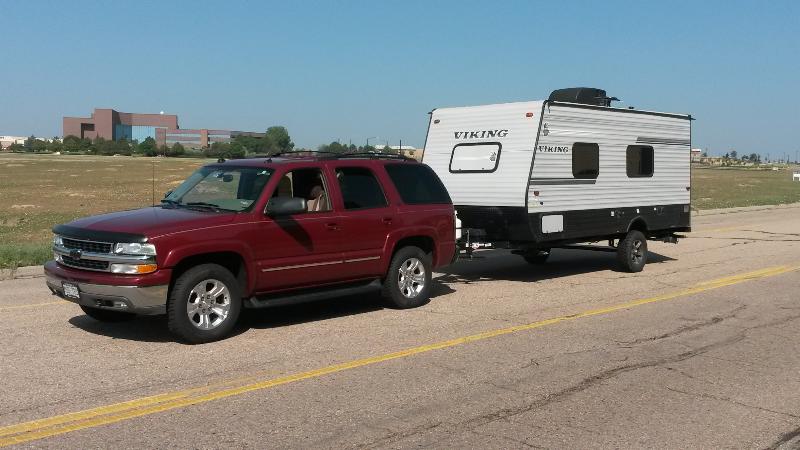

I have to think the RPods would tow a little easier than a regular trailer. My Hoe is similar to yours, Z engine and gearing, and here a pic of the 17-footer I pulled last year out to Glenwood Springs and over the Grand Mesa. No problems at all -- just my normal complaints about shift points (tow/haul mode helps):
I start out at about 6,000 ft above mean sea level and go up from there, going over several 10,000 and 11,000 ft passes. I do need to get a tune to help out but stock should pull the RPod just fine. I'll be renting a 179 or 189 later this summer so I'll get some firsthand knowledge then. I like to fill up with E85 for the octane boost before starting out, but it's hard to find in the mountains and along the way.
EDIT: if you have a transmission temp gauge that would be one thing to watch, and you might want to consider upgrading the tranny cooler to a TruCool or similar.

^^^What he said about the tranny cooler. But besides the tune, my Tahoe is mostly stock and I think it hauls very well, the power is definitely there. I Plan on upgrading the cooler soon and getting a trans temp gauge.
