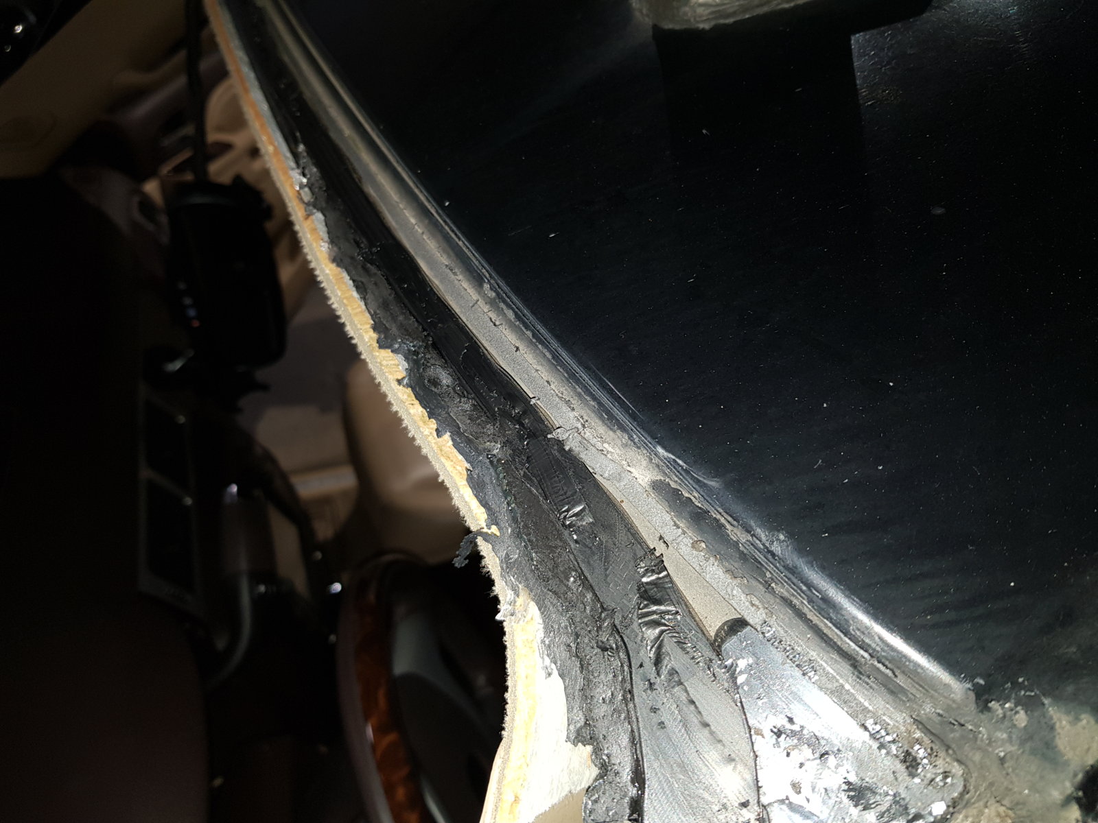

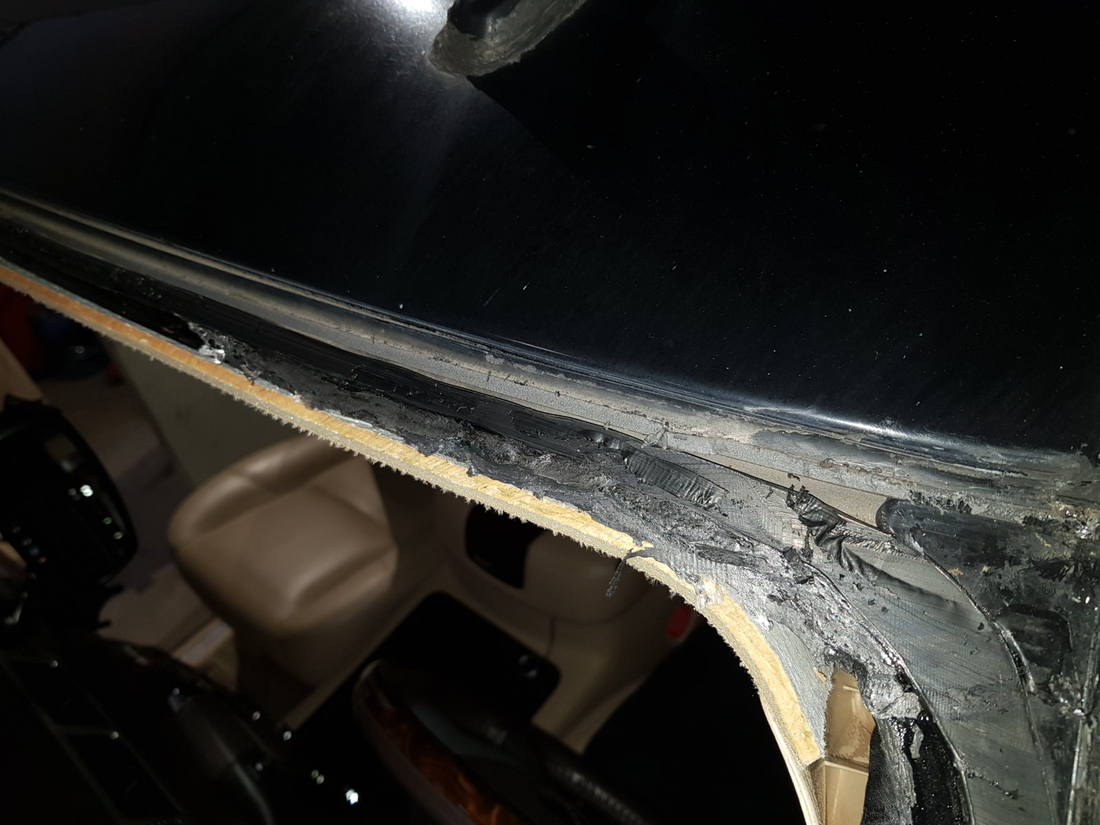

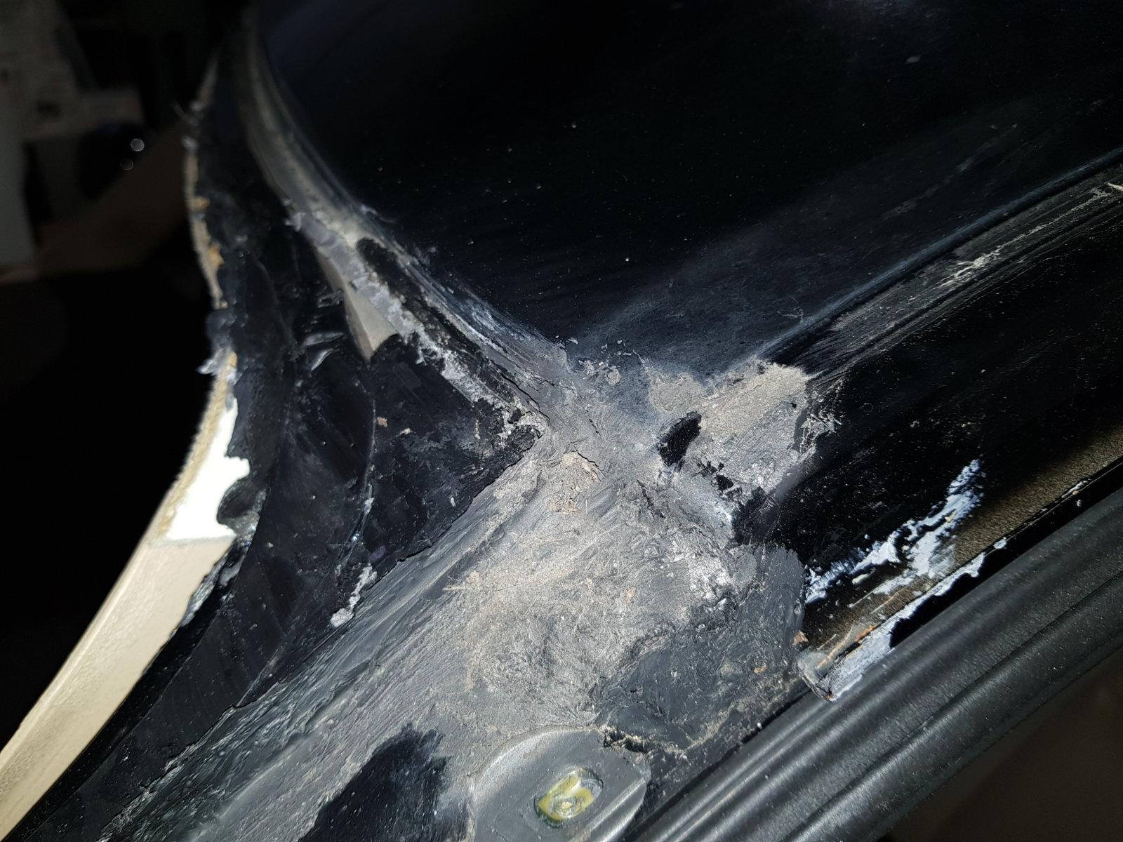

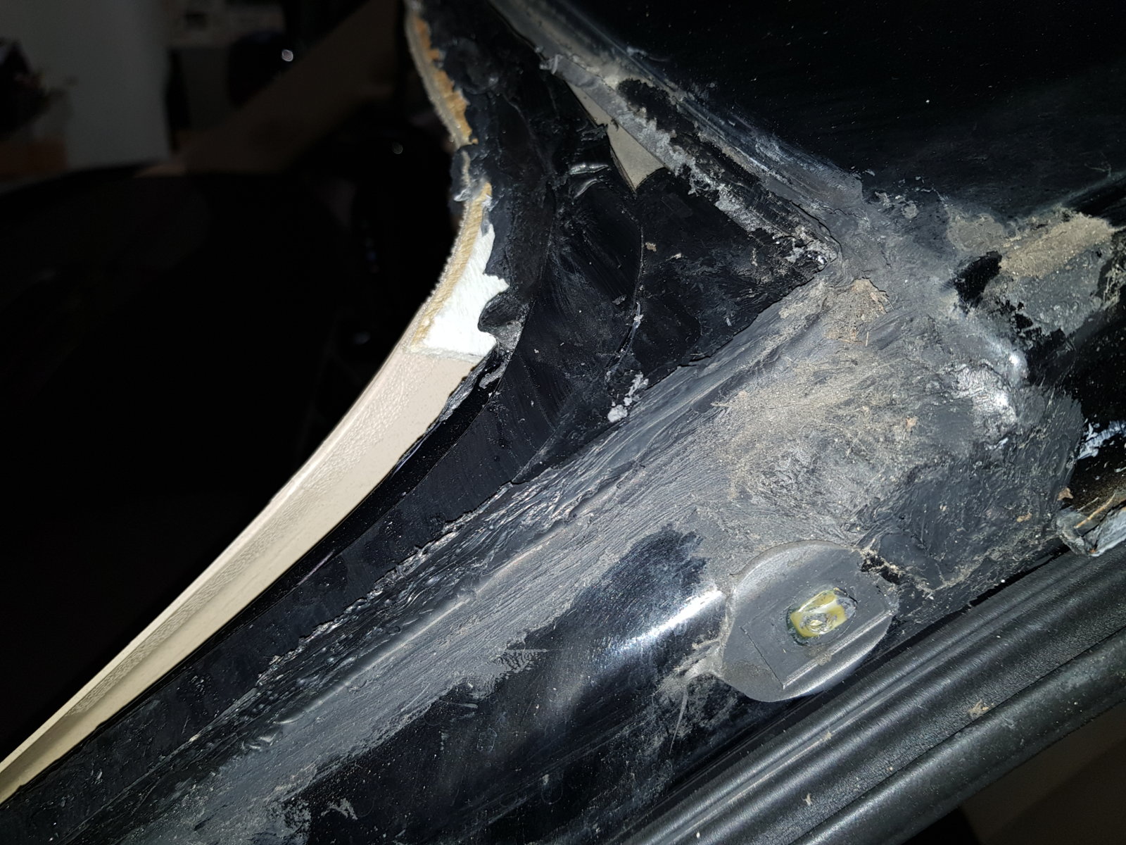

I've been battling this ever since. I've had a "professional" come out 2-3 times. The leak is coming from a body seam directly above the visor. You have to pull down the headliner to see it. It was a 2.5 inch gap in the upper left corner of the windshield, right in front of the driver's sun visor. The water would enter, not touch any of the headliner, but would instead siphon itself masked by running down the wires behind the A-pillar, directly behind the dash, then spraying all over the wires and then leaking down to the floorpan area. This is the reason why there was no evidence of water stains on the headliner. He repaired it with dum dum and liquid metal, but his repair job failed. It developed a huge hole and water was literally started pouring in from it again. The hole is smack in the center of the picture.

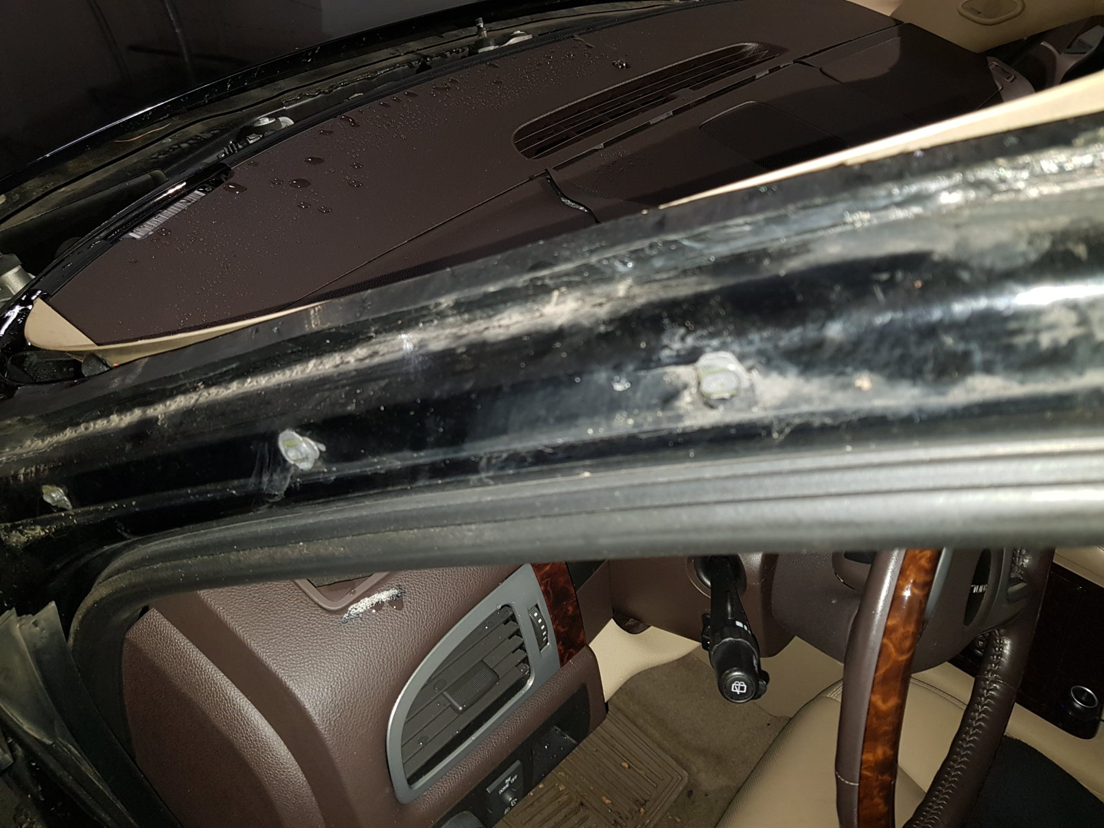

I started to think outside the box. This vehicle is obviously still leaking, so there was no way that it could be “fixed”. I discovered that, opposing logic, it was with the hose pointing backwards (towards the rear of the vehicle) resting on the top doorseam that I was able to make it pour inside, exactly like it would when it rained. In this orientation, it wasn’t hit or miss anymore: the vehicle leaks 100% every time when tested like this.
See that location in the picture above where I've strategically placed the hose? It leaks only when water is pooled up heavily in that location and streaming down back down towards the front into the gutter (windshield) crevice area.
It has to do with water pressure, I believe. If I let the water pool up at any place up front at the driver's door, or spray water DIRECTLY down right onto the seam area where the top corner of the windshield meets the body, it doesn't even leak...yet, when I let it pool up in that location further down (as the pic shows), it leaks reliably.

It's 100% not the sharkfin. When I run these water tests, the water never even touches it. Also, we checked the sharkfin extensively and ran water everywhere around it and it didn't leak, so it's definitely not that.
I'm able to reproduce this leak by literally just keeping the water pouring/pooling on the left side water channel, right above the door sill as shown in the pic that has the hose. No water ever touches anything else: not the windshield (not directly over it, but down the gutter side channel only), not the sunroof, not the sharkfin, not the luggage rack.
