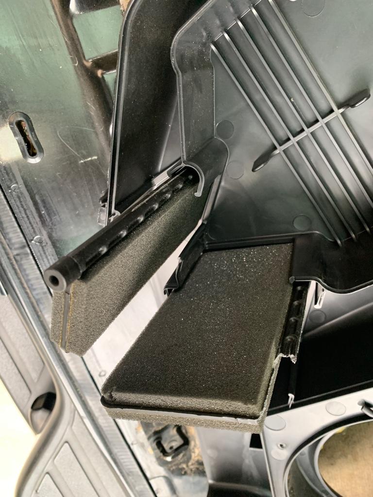

![55d03962c59c96fc00bffa4005bc511a.jpg 55d03962c59c96fc00bffa4005bc511a.jpg](https://www.tahoeyukonforum.com/data/attachments/328/328126-8c6a7686c716ea6cf4da5c253cf00a91.jpg)
- flap on the right with a broken rod
The flap with the broken rod was unable to pivot and divert the cold air through the rear air system.

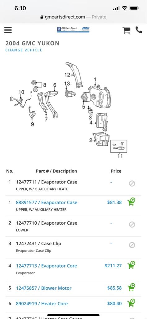

![0cfbca258e3d1f91c0bceb6ada7898b2.jpg 0cfbca258e3d1f91c0bceb6ada7898b2.jpg](https://www.tahoeyukonforum.com/data/attachments/328/328127-6a60f68861a21f337da73f30cbbde453.jpg)
The part is shown as #1 in the image above. I was able to pick one up at the local junk yard for $40.
Once I replaced the evaporator case, cold air was flowing in the rear.
