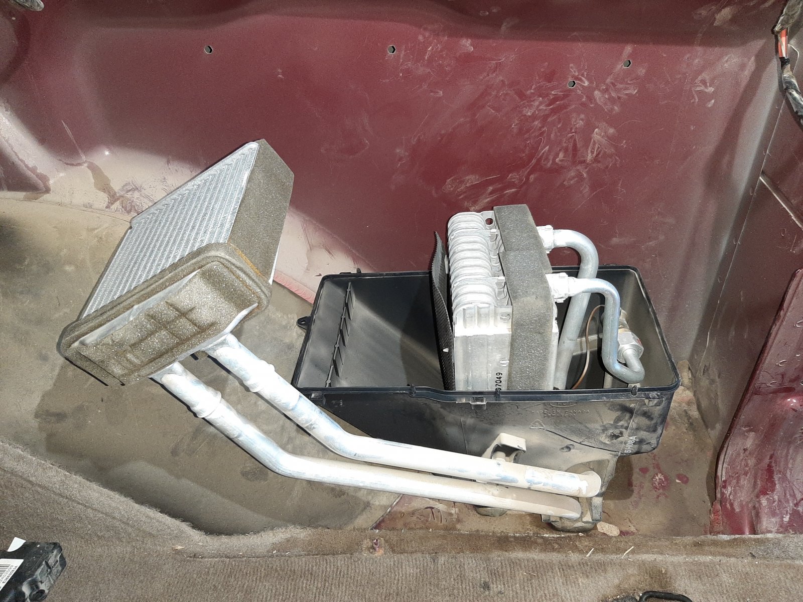

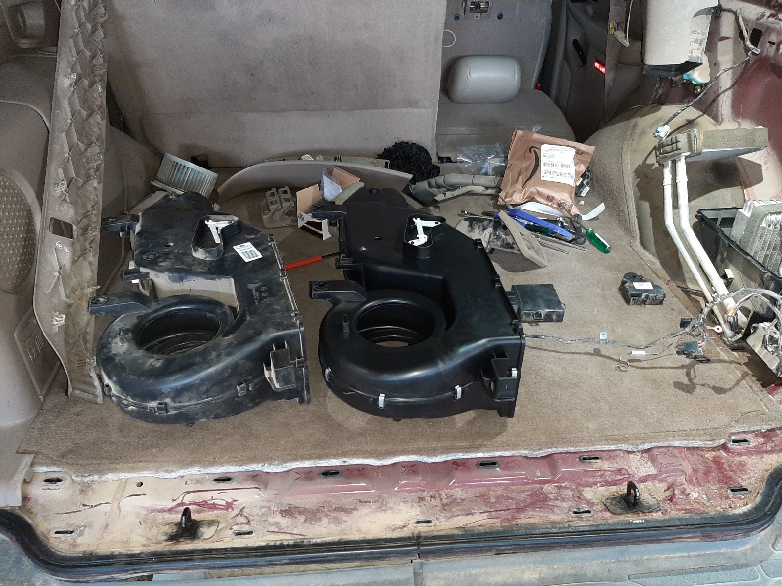

Sorry it has been a couple days but finally got to it yesterday. Took about an hour or hour and a half. The only real problem I had was there are 2 studs in the lower case that go down through the floor in amongst the 4 heat and AC lines. You need to loosen the nuts on them (10mm deep socket) so you can wiggle things around enough to get the top case off. Just my luck both studs backed out of the case. That took an extra 15 minutes to figure out. Here are a couple pic's to show you what you are up against. Overall, pretty easy job. I had already bought 2 actuators when I thought that was the problem. Since they are easy to change, I reinstalled the old ones and they work fine. Guess I have 2 on the shelf for when they do die.
