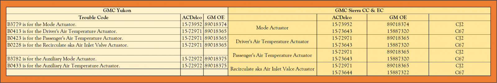

For about a year now the rear air in 09 Yukon SLT XFE has only been blowing out of the floor. It happened once when I disconnected the battery and then it started switching again after a couple days. Then another time it went to the floor and never came back. Im pretty sure the mode actuator is done. I think this is what I need, can anyone confirm?
Also having a tough time finding a video on how to but Im guessing the rear air, being how it is in that box in the rear is much easier to work on and I can figure it out pretty quick without a video but if anyone has any tips, Id appreciate it!
