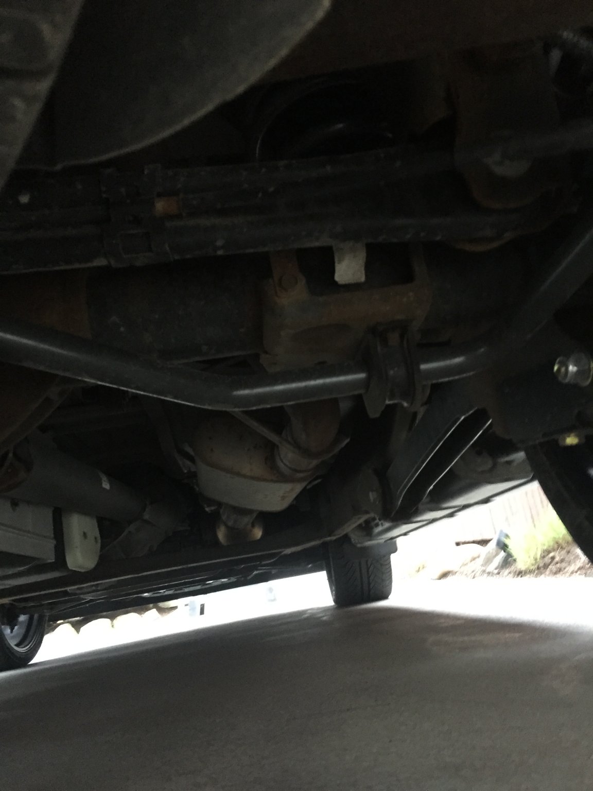

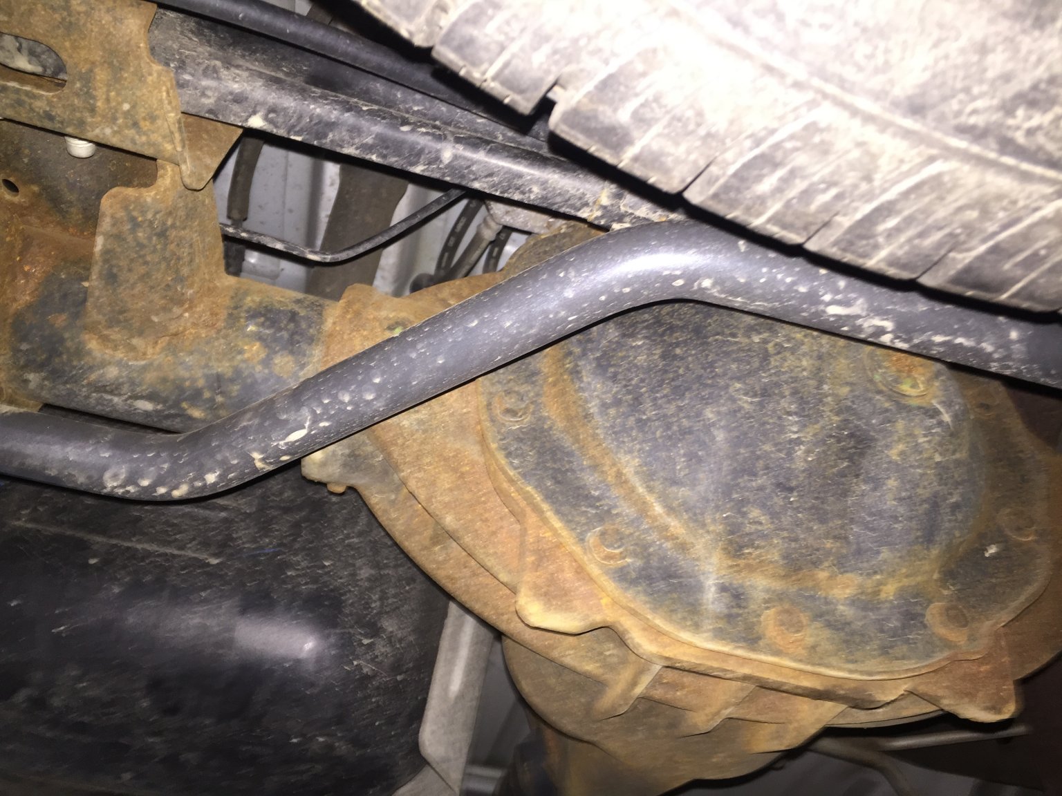

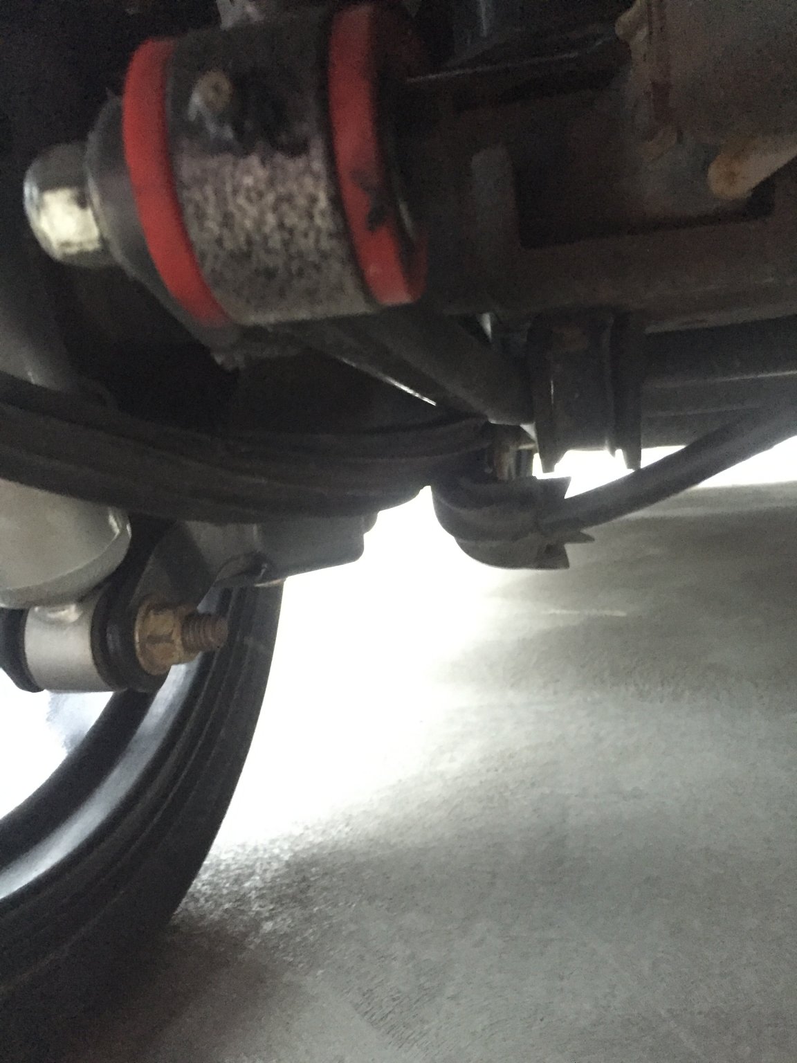

All,
Looking for input on above. 2013 Tahoe LT
I got the 4" 5305 Belltech drop coils with same Belltech SP shocks but I have a 2" spacer currently for a 2" rear lift and back end is bit bumpy. I don't want to lower any more than it currently is as I need rear travel. Mind you have I have 295/35/24 tires and rims but was wondering if anything I can do to make rear bit smoother driving. I have over 2" clearance from bumpstops and frame so it is not bottoming out by any means.
Any way to get a more forgiving rear coil?
Thanks for input and suggestions!

295 35 24 will hit the suspension harder. is the swaybar pointing down?

you relocated the drivers side bracket on axle correct?
also endlinks are max 30 lbs
Sway are I bought from you for 2013 Tahoe didn't have any relocation brackets. Is this something I need to do or not required. If required what do I need to do or modify?
NORCAL SS
SUV SUSPENSION GURU
Supporting Vendor
Jun 9, 2009
8,744
608
No I have the shorter endlinks
