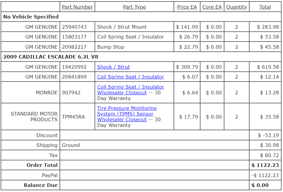

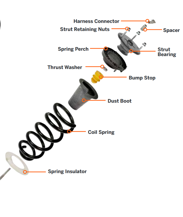

There’s no fully loaded OEM strut for the 07-14 z55 / z95 anymore.
Worth it’s weight in gold to buy the OEM parts a la carte. On a few boots and goodies I did MOOG & aftermarket. MOOG has replacement springs on R/A right now. Your current springs should be ok. Save them as they’re NLA if you don’t like the MOOG.
Dorman assemblies were having frequent returns for leaks since introduced.
@petethepug, I will reuse my springs unless a reason not too. I plan to get the oem strut and oem bump stop. Anything else I should replace? Thx
