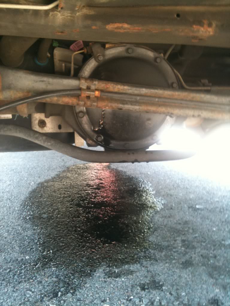

without them inspecting it yet I did a ton of research last night and I have come to the conclusion that it was the infamous GM Gov-Lok that shattered
too many one wheel burnouts and it tried engaging so it broke
it was pretty scary getting it to the shop today
getting the Eaton Posi LSD and 4.56 gears all for around $1100
should be done tomorrow
I just can't wait until I hit that 500 mile mark, replace the fluid and smash on it :D
going to be a big difference from stock 3.73's

my gov-lock?
...OH! you mean my grenade lock haha!!!
yeah it did they said it was pretty messed up when they took the cover off
and $1100 was a quote I got before they looked at it
they called right before they closed to confirm what they need to do tomorrow and it will be right around $1600 for the Eaton Posi and gears
this better be worth it!

well I forgot the breakdown of what went in but I can try to remember parts and what not
upon inspection.. positraction snapped, pinion teeth rough, metal in housing, and at the bottom of the pumpkin, and a couple other things messed up
they installed..
GM Eaton Positraction $595
4.56 Ring and Pinion $295
all the seals, bearings, and necessary install mumbo jumbo
Labor $340
grand total of $1625.80
