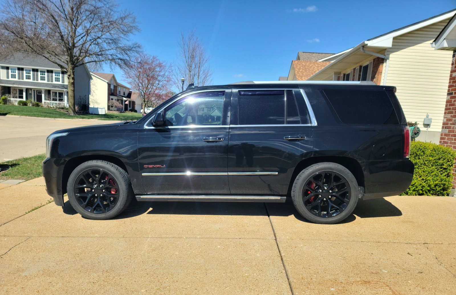

I just installed Arnott SK-3353 and AS-3066 shocks on my 2016 Denali. 3 years ago i installed 2/4 drop kit from Norcal. For some reason rear dropped from 34.5 to 33" with just installing Arnott AS-3066 shocks. I was using 2.70" rods. I tried unhooking airlines and height was still at 33" so i was riding on springs only.. I tried making rod 3"' but only raised to 33.5. So i had to install 1" spacer that came with Norcal kit to bring it back to 34.5" with 3" rod.
I dont know if enyone else had this issue

Factory magnaride on front and rear.
I didnt meassure but i think Arnott AS-3066 maybe little sorter than OEM or airbag placement doesnt hold same height as OEM. Im probably only one complaining and i bet evevryone else like to have free 1" drop or rear with Arnott AS-3066
Btw i like little bit of rake and yeah i havent wash it for a while
