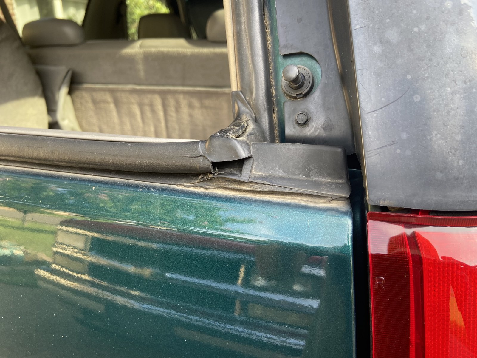

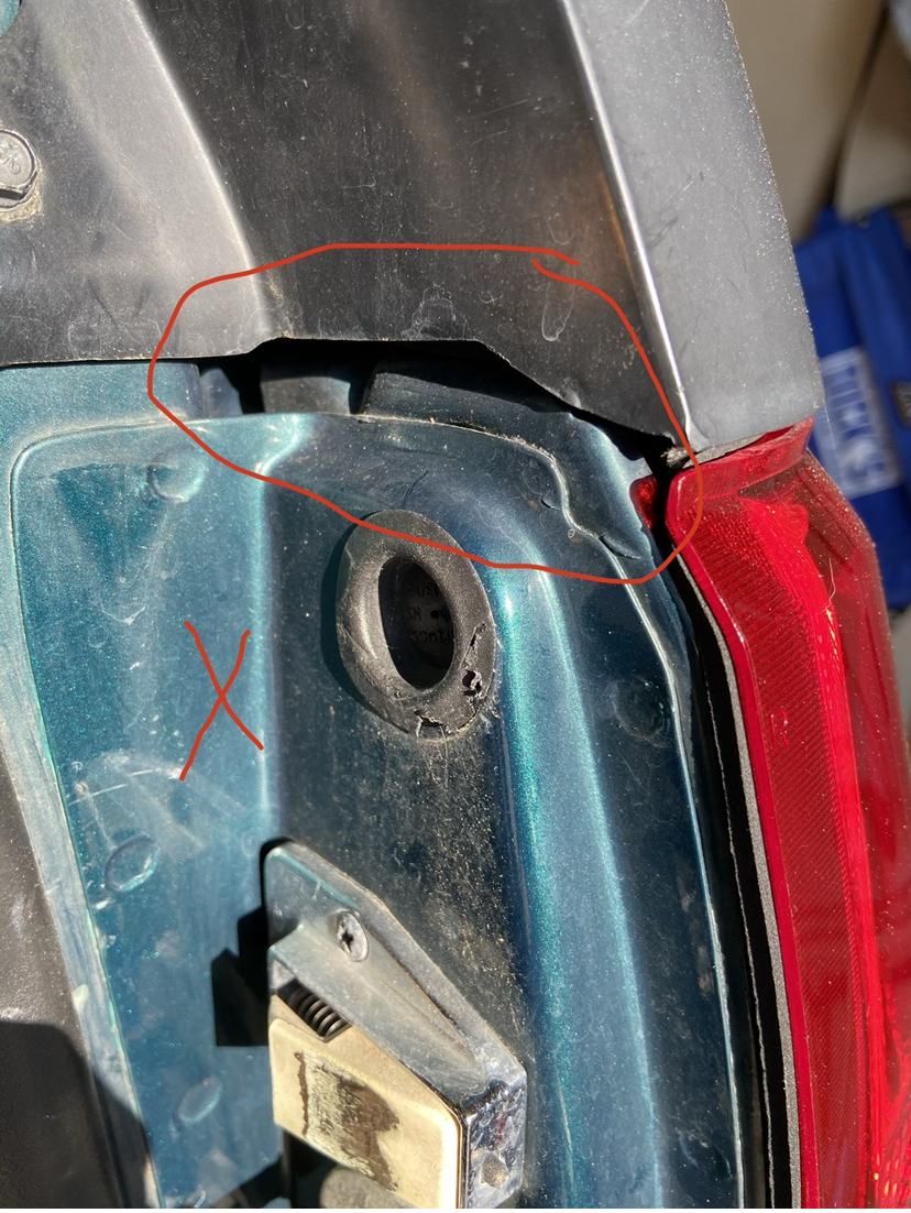

Might not be the correct way to fix it but if you have no other option, I would get some weatherstrip and add a strip along the edge of the liftgate. You may have to push a little harder to get it closed but it would seal.
Yeah, I've added pieces of weatherstripping to try to seal it and it still finds a path. I have the tailgate gasket raised by goobering RTV under it to bring it up and close the gap, but it looks like crap.

This is definitely an adjustment issue and/or some worn out parts in the latch itself. That glass should be flush with the rear trim. I know you've done all kinds of adjusting on it but that has to be the issue. I found these old threads which I'm sure you've already seen...but here they are.
http://www.tahoeyukonforum.com/threads/for-guys-running-the-tailgates.18718/
http://www.gmtruckclub.com/forum/threads/rear-glass-wont-lock-in-when-closed.134645/
Sent from my SAMSUNG-SM-G930A using Tapatalk
Thanks for the links. In that second one, the poster said that the tailgate had sagged, causing the liftglass hatch to be too high.
That's something to look into, will take a look at it and see how it hits.

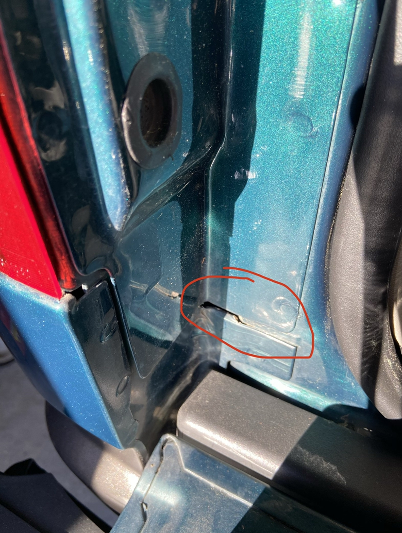

The driver side glass edge is flush (and there is no gap with the tailgate gasket) but the passenger side sticks out about 1/4" and has the gasket gap.
You're right...it has to be an alignment issue. I'm going to loosen all liftglass hinge bolts, rest the glass closed and have someone push it down and into place--and hopefully close the gap--while tightening the hinge bolts.
Maybe that'll work...

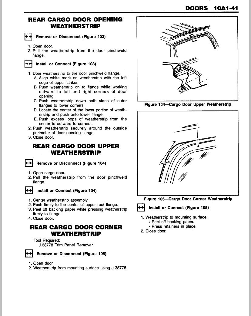

I just bought a 98 two door with the tailgate and it's leaking along the top of the lift glass.
The weatherstripping looks great but the top piece attached to the truck had the flap pushed inside the lift glass. I pulled it out so the lip now rests on top of the glass. Is this how it is supposed to be?

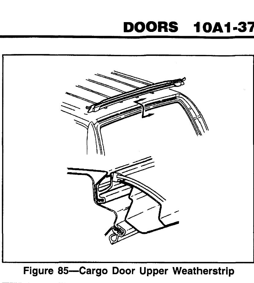

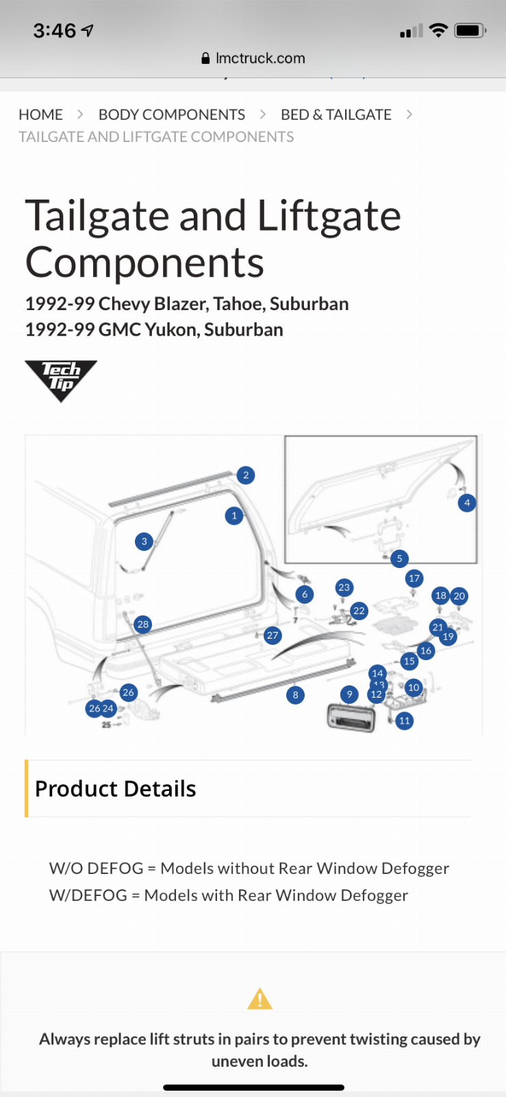

Hi, sorry for the rebump, I bought a 95 Tahoe and I'm replacing the rear weatherstripping.
Bought the 3 rear seals from LMC, but the I cant install the top one the way you have it installed on the picture. It's like the glass hatch is too far away from the roof. Do you need to glue the lip to the glass? What am I missing?
Thanks for the help.

It was a colossal pain in the ass to get it that way. I didn’t glue it or anything, it pushes onto the weld lip thing and the top flap naturally rests flat.
With the hatch open, I took a screwdriver and pushed the top flap up through the opening, inch by inch, to get it to rest on top of the glass. It tore in some places.
It would be easier to remove the liftglass, but then you’d have to have someone hold the flap up, align the hinges and get it into position without the flap coming down.
I don’t know how they did it in Detroit on the assembly line, but there has to be an easier way to accomplish this.
Or, maybe the flap isn’t supposed to go on top after all. The GM manual doesn’t say.

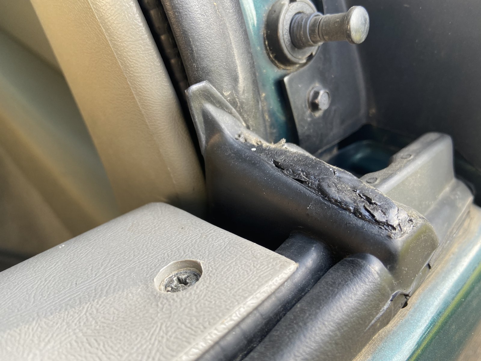

It is somewhat adjustable. Going by memory here so I may have this backward, but the hinge bolts on the body side can be loosened and the whole thing pushed in a little. There is a plate that the bolts go into. It isn’t captive, but can be repositioned if you can get your hands up in there.
It’s really a two person job, and removing the support struts may give it more leeway. I would try closing it and having someone outside pushing in at the top. Then someone inside the cargo area tightening the nuts down.
