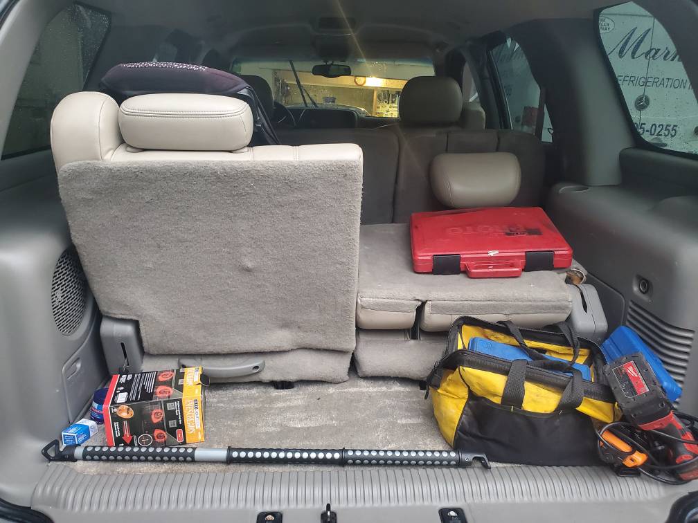

Just picked up split bench rear seats from my local salvage yard! Excited to get them installed

Yes! All done.
Like i said, we got a split bench in really good condition from the local scrap yard. Picked that up as well as all the brackets, bolts, and plastic trim pieces.
It was very straight forward. There were metal covers with a caulk adhesive over them covering the bolt holes in my truck.
So, just had to take some trim pieces off and pull the carpet and padding back. Used a hammer and screwdriver and pried all those metal tabs out. The bolt holes are just hex nuts welded onto the bottom of the floor pan. I put a metal pipe cleaner on my drill and really cleaned out the threads in the nuts before putting the bolts in. They all went in with my drill.
Put all brackets in, cut holes in padding and carpet, and it all fits like a glove!
Looks 100% factory. Im very happy how this turned out.
Thanks a bunch for the input and likes guys!!
