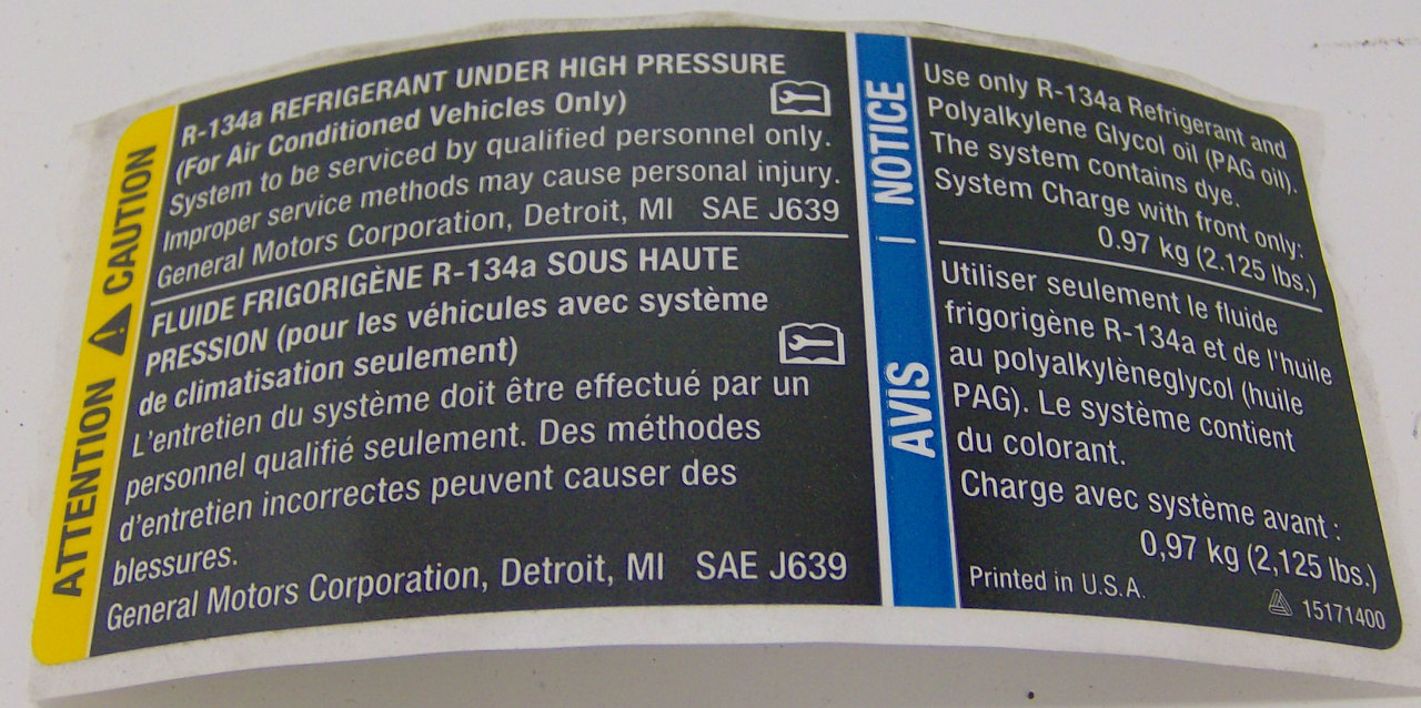

english-french-refrigerant-warning-lable-gm-part-1.jpg The under hood label should look similar to this one, the amount differs from each vehicle, good luck.

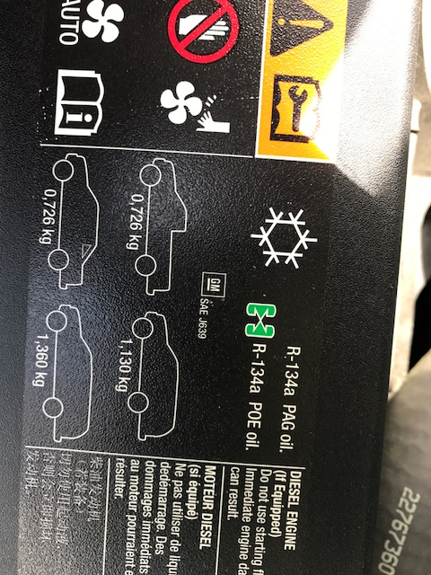

hope that helps. that's from my 2011. looks like 1.130kg sorry for the crappy photo

I think I finally found it... and it looks to the be the same as your tag.. 40oz.. (2.5lbs.)
