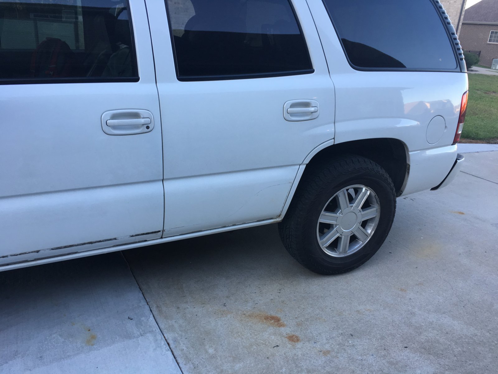

Sounds like you have the right process. I did the same thing on my Denali. It'll take some time to cleanup all the adhesive residue. I just kept using the eraser wheel and liquid rubbing compound. I did have some rust on the rear quarters that was uncovered once the cladding was removed. Had to get both rear lower quarters replaced.
I don't care much for the Denali cladding either. But when buying used, can't always wait for the exact one you want. That was my case. I got a great deal and really wanted the 6.0 for towing our camper. So now I just need to swap front ends for the later year Sierra and get me a chrome rear bumper.
Oh...once you have it all removed...put it on CL and recoup a few dollars! Someone will want it!

I am interested in the stuff depending on location!
I have removed all the cladding and running boards. Denali is white. Everything is 100% intact and functional. I am located in Middle TN (I’ll be in Huntsville, AL) this weekend. Let me know if you are interested.
