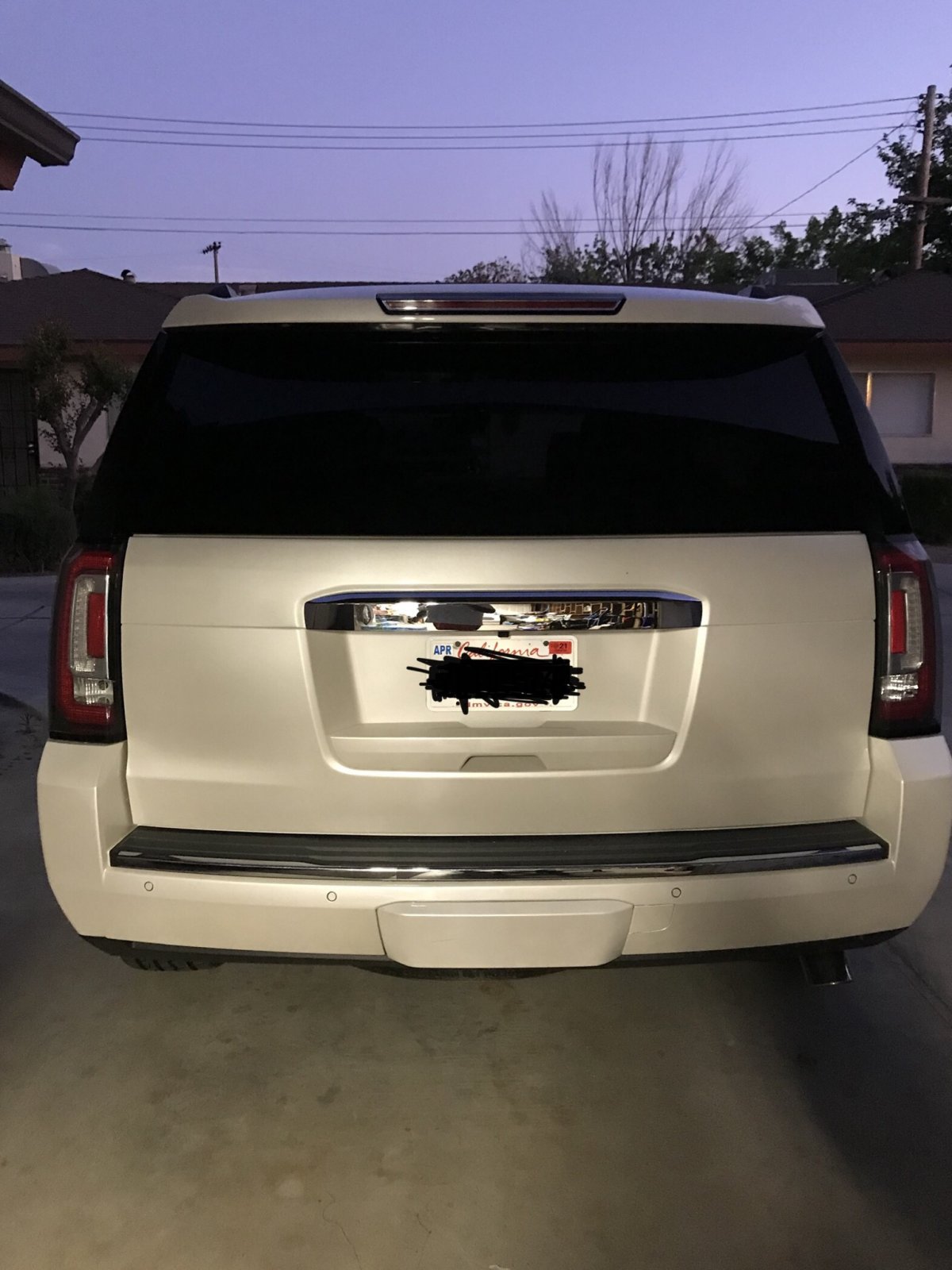

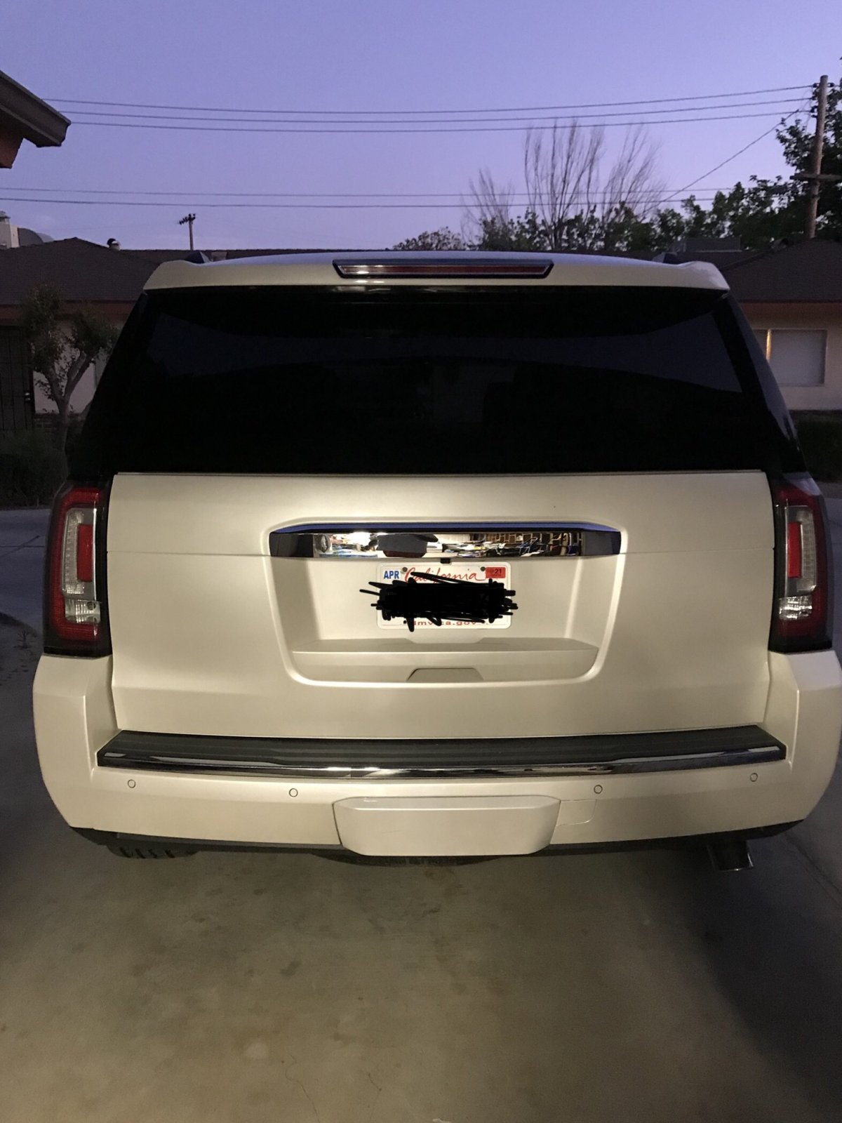

I'm told removing the rear emblem from the 2016 Tahoe will leave holes in the tailgate. True?
toi
May 24, 2012
235
62
pics of the debadged rear end please
VICDBOSS
Sep 5, 2014
153
22
Nope. Smooth as a baby's bottom. I also debadged the whole car. Looks clean.
