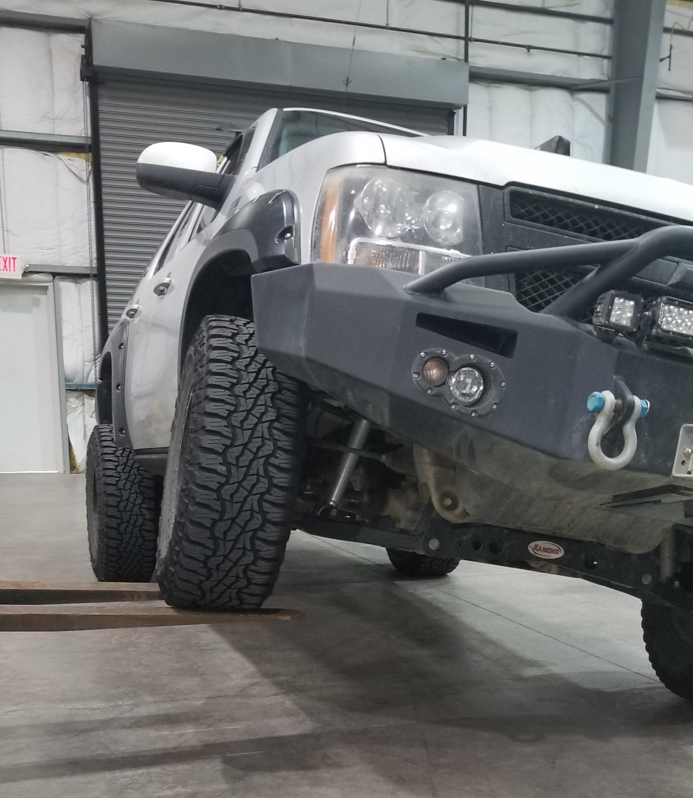

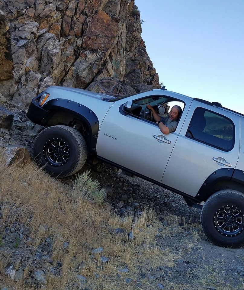

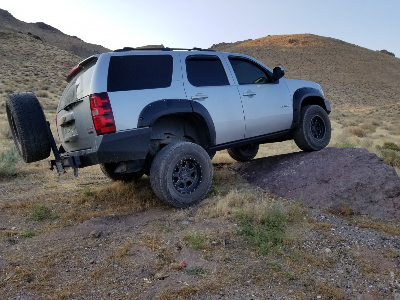

Fwiw I removed the front sway bar and think it handles better off road and have had no issues on pavement. Mine hasn't had a rear sway bar ( or prior owner removed it). 3" suspension & 3" body lift on 33's and no substantial body roll imo.
