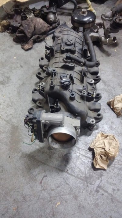

What vehicles did that 1 year only intake come on?
Finally found one of these hen's teeth intake manifold. Now that I have it in hand, I put it next to my 04 truck manifold and see there are a few small differences between the 87mm TB version of truck manifold and the 04 truck manifold, such as which vacuum ports are plugged and which are open, and the location and style of the Evap purge sol'n & the MAP sensor. I'm considering running this so I can keep my Flexfuel rail with return line and not have to contend with the other ways to make it work on the later TBSS/NNBS intake manifold. Here is a picture of the hen's teeth manifold for TonyRodz.
Sorry for the hijack m1949. This was the only place we discussed this manifold.
So what vehicle did it come from? Other then having a bigger throttle body bore, think there's any other significant improvements? Thx for posting the pic btw.
This one is found on an 05 Chevy Trailblazer / GMC Envoy with a LH6 5.3 as mentioned when first discussed. The only other vehicle I've heard this manifold was used on is a Chevy SSR, but never seen one to confirm it. From what I've read a lot of the improvement when swapping to a TBSS/NNBS intake manifold comes from the larger 87mm TB, which this manifold also uses. I'd say the TB is it as far as improvement since manifold body itself is the same as the earlier truck manifold. The plus for me with this manifold is the ability to bolt on my 04 return style fuel rail from the original 04 Flexfuel truck manifold. You're welcome.
