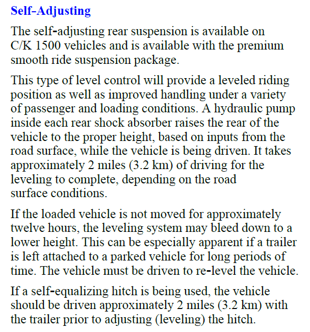

Thank you for the info ! Yes I wan to get rid of compressor and air ride. I think I would prefer option 1. So I do have some questions. The zw7 is a RPO code? The self leveling shocks will adjust by them selfs driving down the road a few miles? Nothing else is needing for them to do this?
Yes, ZW7 is an RPO code to describe a type of suspension. In the 1/2 ton 800 wagons like yours, GM used 3 different configurations. The two I referenced in my earlier post and yours should be Z55 with G69. The Nivomats are self-contained and have no external moving parts, they adjust and level the truck themselves.
Here's the description from a 2002 Tahoe and Suburban electronic owner's manual:

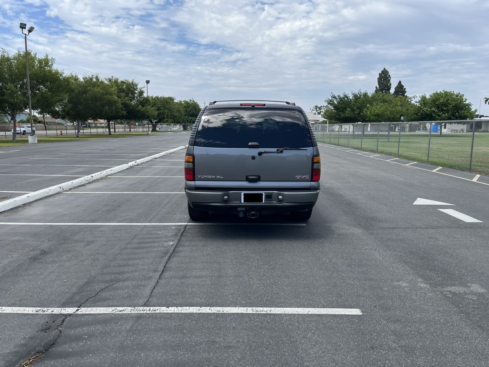

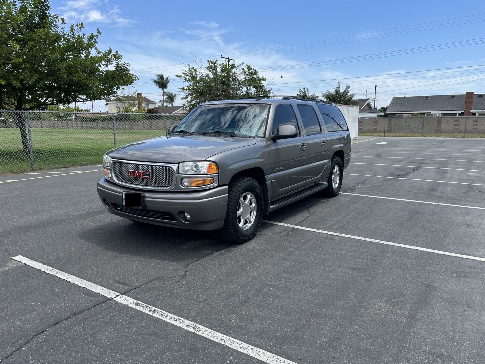

Would doing option 2 with Bilstein 5100's and Moog coil springs be better, or would you stick with the oem? Ideally I'd like to just repair my air ride but I do want about a 2" lift, which I don't see much info on except that I would need shock extender brackets, so I'm thinking of just doing option 2 and crank torsion keys a little up front. I have an 06 Yukon Denali XL
You have to define "better". Is Option 2 simpler and less maintenance? Yes. Does it ride as nice as original? No.
You have to search for the many posts on guys who kept their air ride, self-leveling suspension with a mild lift.

Sorry for the confusion. I meant which was “better” for option 2 between using ac delco parts vs the bilstein/moog (not in comparison to stock air ride)
And I must be bad at research but for the life of me I can’t find many who kept the air ride and did a mild lift lol, it’s usually either delete it and lift or keep air ride no lift. I did find one guy who commented on a YouTube video that he did a 3” lift , kept air ride using shock extender brackets, unfortunately I don’t know if he’s around anymore. I’m completely in the dark with suspension so I would need to know what all do I need and where it’s recommended to buy said parts.

I didnt think there was a coil over option for the NBS, because of the torsion arms? Shocks are straight forward, and many parts warehouses sell a conversion kit to fool the Z55/Z95 system.
Atomic fabrication makes a coil over conversion to delete the torsion bars all together for lifted and lowered applications.
He uses Viking coil overs which actually in the research is a pretty decent coil over for the money and haven’t seen any complaints about them.

You can swap to bilsteins they should have some for a 0-2” lift on eBay or Amazon. You’ll need dummy sensors for the air ride so you don’t get lights in the dash. Mines lit up like a Christmas tree but I don’t really care
If you wanted to keep the air ride you could also use shock extenders
Stocks nice but I always try to find a way to upgrade when I replace a part if I’m able I’ll spend the extra money to get something that’s going to be stronger last longer and ride better especially if I’m driving it every day.
