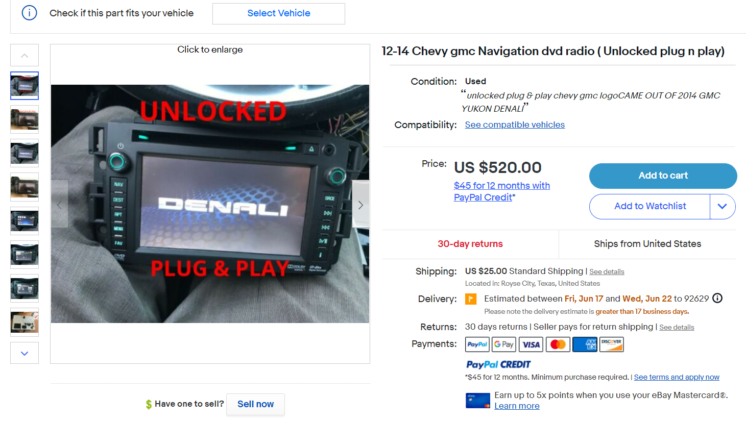

My goal was to stay OEM and upgrade to the 12, 13, 14 HDD (Hard Disc Drive) System that looks similar to the DVD based system for 07-11 Tahoe, Yukon & Burb. It's essentially what GM installed in the Escalade in 12, 13, 14 that's an SD data card system for what they already called SuperNav.
They are showing up for a lot less dough now and considered an OEM head unit by insurance and looked over by poachers are their older siblings DVD based system. They also have an internal hard drive to store music, XM Live weather and traffic. They are GM part # ...
22856825
22815130
22870863
23180744
22923616
This example is from an eBay seller with knowledge on how to unlock the unit back to NEW so that the first truck it's installed in will learn it's VIN and ONLY that VIN. After that a GM Tech2 device or other is needed to add a new VIN to take it out of "theft lock" status.

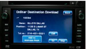

If you swap your OnStar VCIM to 2010+ you can also use the OnStar cell app to remote start, lock, unlock and beam navi directions into the Navi from your phone.

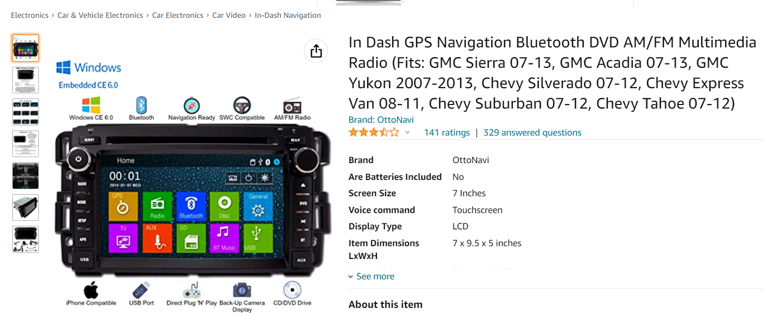

Beside the Tesla style units there's the Android aftermarket units too. If you have rear seat entertainment (RSE) you'll likely be paying for adapters for that and the steering wheel controls. All the stuff previously mentioned above is OEM and already integrated into the RSE, steering wheel controls and voice controls for BT & OnStar.
