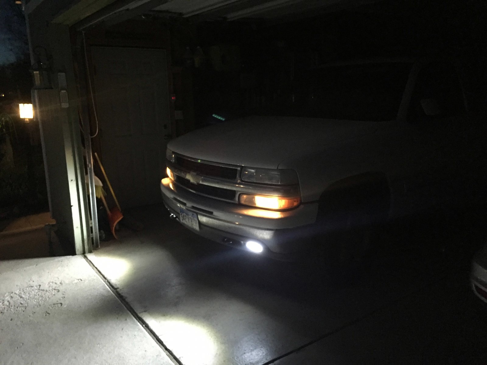

Oh, how did you do your projector install?
I custom mounted them to the factory bracket. They fit perfectly in the opening. Just barely wedged and snug in the rectangle opening which keeps them from vibrating and flopping around

I custom mounted them to the factory bracket. They fit perfectly in the opening. Just barely wedged and snug in the rectangle opening which keeps them from vibrating and flopping around View attachment 223103
OIC That looks quite good on your truck. I fear that If I tried to do that on my esky front it would look like something was missing. I was thinking more along the lines of a typical retrofit where the projector was installed into the housing behind a lense. I dunno maybe im overthinking it and should just try ordering some cheapo projectors and see how it looks lol.
I was wondering if you meant a retro. Yea mine are pretty hidden and I don’t feel like they’re out of place. A retrofit would be super hard in those housings. Up to you , I like my idea and I think they will look good on your esky. Just $50 to try out
