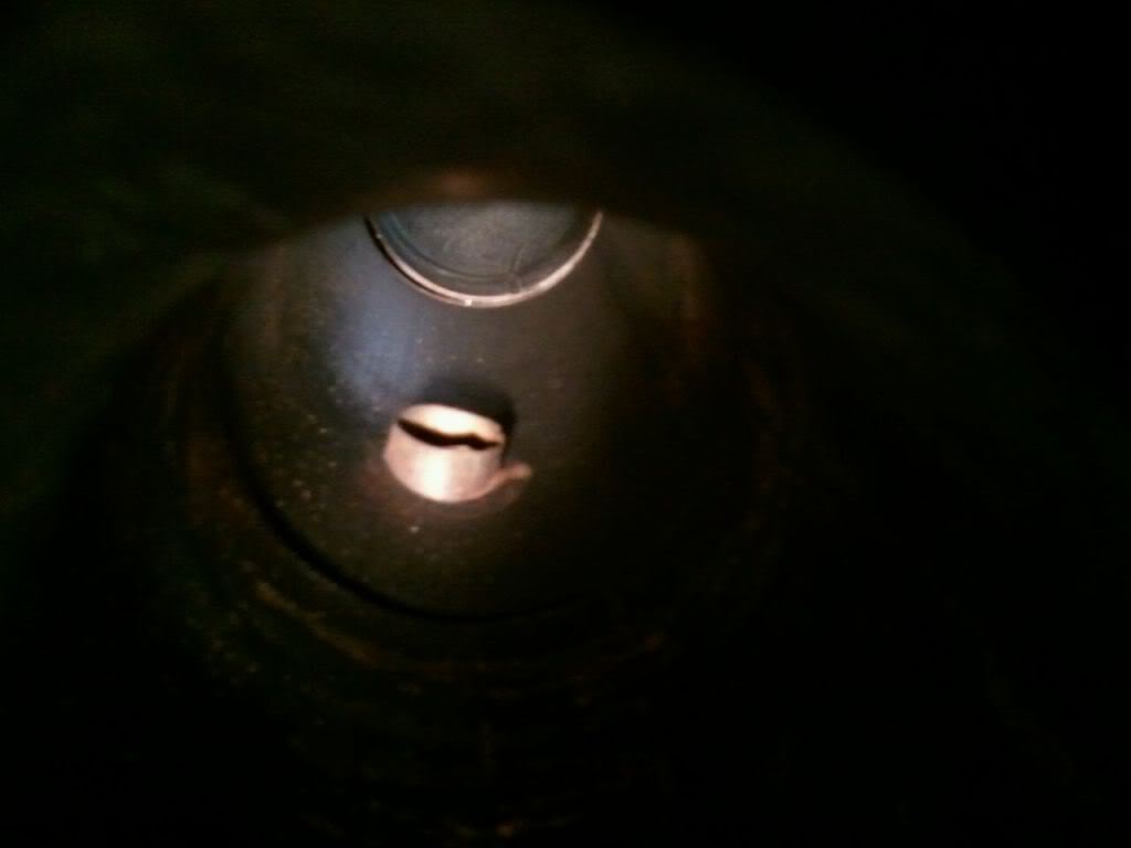

the resonator i removed it barly made the truck louder. The resonator is solid inside only a little hole in the middle check it out.
