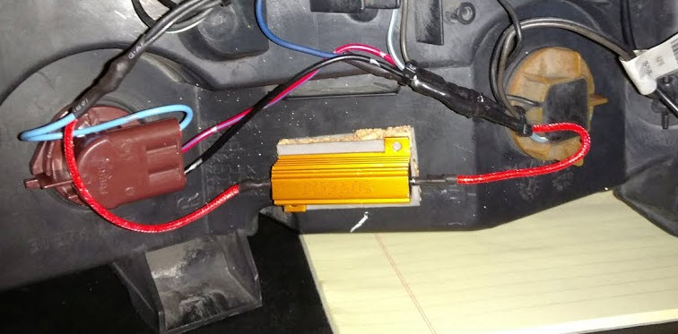

This was my solution. Used outdoor double-sided tape and a piece of cork board and mounted it on that. No problems at all and out the way of other cables. I did the dual DRL/Turn signal mod.
