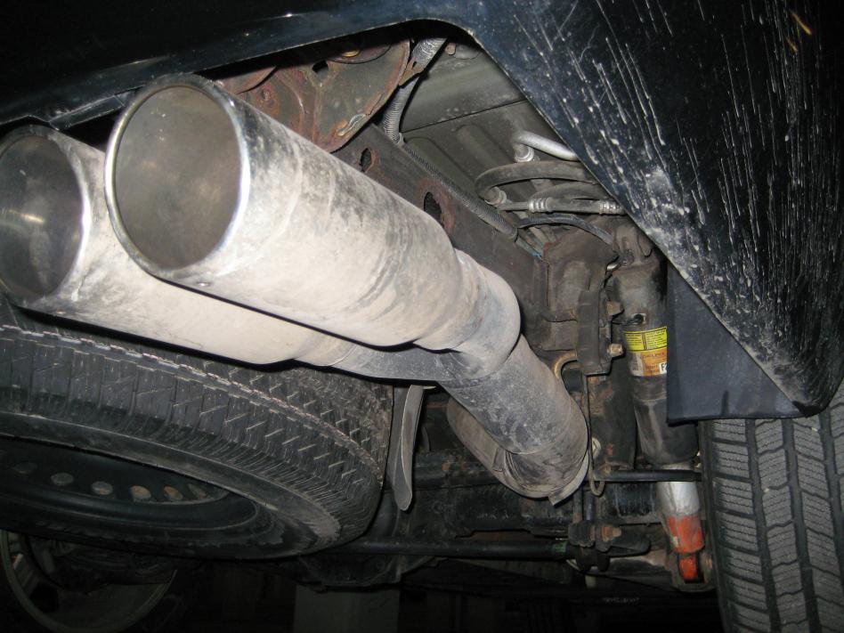

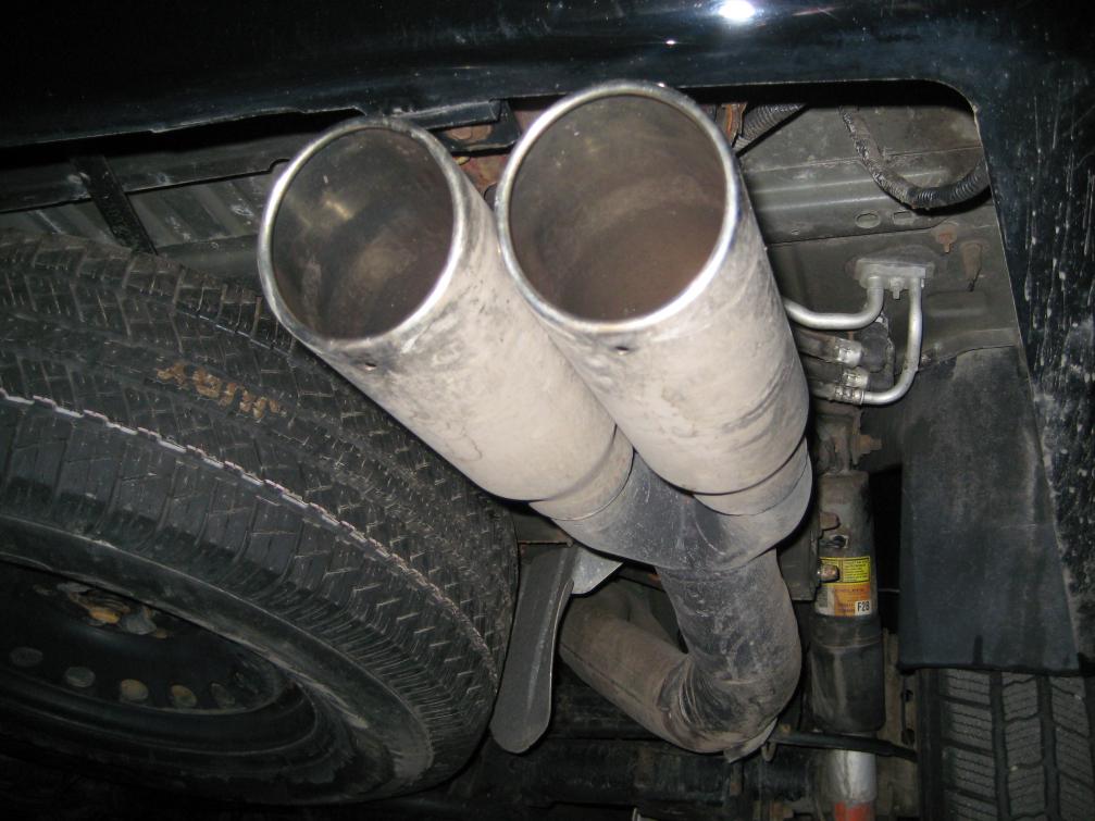

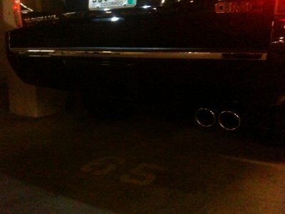

I took some pics, please ignore the dirty-as-hell tips... its been super sloppy here lately.
I had the shop put a couple bends in it so you couldn't see any pipe besides the tip from the back or side. Came out pretty nice IMO
The tips are stainless magnaflow 4" angle cut tips
